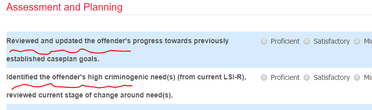

I am using a fixed number of table rows with the row label as the questionnaire objective.   When the row label is long and wraps to another line blank space is inserted.    Is there a way to remove this space?

Hi Andrew,
Did you mean you would like the line height to be smaller like this?
If so, you can try the following custom CSS:
.col0 {
  line-height: 1.6em!important;
replied on March 6, 2018
Exactly what I was looking for, thank you.   This questionnaire looks so much better now.    I had tried line-height, and 10 other properties, but was using the  wrong selector.      Thanks again.
