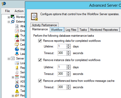

I have the advanced server options set in the WF Admin Console to remove reporting and instance data older than 1 day in hopes of reducing my 26.4GB workflow.mdf file.
I have to run a mass import (~150,000 documents) for a customer in the near future.  I ran the import once as a test run which ballooned the mdf up to 26GB.  I then modified the settings as shown above, but the database has not reduced in size after about a week of having these new settings.  I have also tried to manually shrink the database and files from Sql Mgmt Studio with no change in the workflow mdf file.

I appreciate the message, but the log file isn't an issue - only the mdf.  The track tokens certainly don't help the workflow mdf size, but as long as WF Admin Console wipes old data, then it shouldn't be an issue.
Still not sure if I'm missing a setting somewhere that would trigger the deletion of old data, or why the maintenance doesn't seem to be occurring.

Check your database maintenance timer in the Workflow Admin Console. By default, it has a fairly small work window so it does not interfere with performance. If there are lots of instances to delete, it may take a while to purge them from the database. You can increase the maintenance window temporarily to handle the large backlog.
