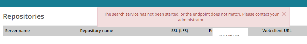

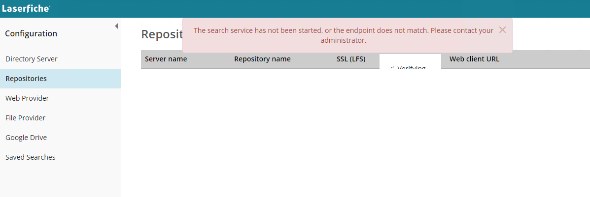

I am setting up a new Federated Search server as part of a new client's LF install and am getting a strange error.  The install itself goes fine and activates against LFDS without issue.
When I launch the Federated search admin page, I get the following error "The search service has not been started, or the endpoint does not match. Please contact your administrator. "
I have verified that the search services are running.  There may be a piece I am missing, but where would I check the endpoint name that needs to match?

Sorry for the late reply, this is an issue for Federated Search 10.3.
First of all, you would need a valid SSL certificate and bind it on port 443. You can check "Requirements for Using SSL/TLS with Laserfiche" section in https://www.laserfiche.com/support/webhelp/Laserfiche/10/en-US/administration/#../Subsystems/LFAdmin/Content/Using_SSL_TLS.htm?Highlight=SSL%20certificate
After that, you can do the following workaround:
  • Stop FederatedSearch service
  • Restart FederatedSearchAdminAppPool and FederatedSearchAppPool in IIS
  • Replace https://localhost/FederatedSearchApi with https://%FQDN%/FederatedSearchApi in the following files. (Please use your fully qualified domain name instead of %FQDN%)
    • %programfiles%\Laserfiche\Federatedsearch\SearchSite\Web.config
    • %programfiles%\Laserfiche\Federatedsearch\AdminSite\Web.config
    • %programfiles%\Laserfiche\Federatedsearch\SearchService\Laserfiche.FederatedSearch.Host.exe.config
    • %programdata%\Laserfiche\Federatedsearch\FederatedSearch.json
    • %programdata%\Laserfiche\Federatedsearch\ServiceContainer.json
  • Start FederatedSearch service
If the error still exists or you have other issues, you might want to open a support case so we can further troubleshoot the problem.

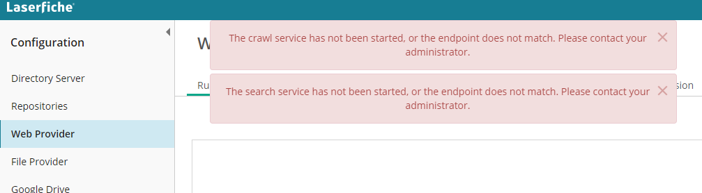

Same for me at first, I tried running the EndpointUtility.exe (as administrator also) but still got that error until I ran through the manual steps of find/replace on the FQDN. I'm still getting errors on the File Provider and Web Provider tabs but will try to get around that - may need to update some config files.
replied on March 26, 2019
Hi Nigel,
For file and web provider, can you please stop "Laserfiche Federated Search Crawler Service" first, and then Replace https://localhost/ with https://%FQDN%/ in the following files. (Please use your fully qualified domain name instead of %FQDN%)
  • %programfiles%\Laserfiche\Federatedsearch\CrawlerAdminSite\Web.config
  • %programfiles%\Laserfiche\Federatedsearch\CrawlerService\Laserfiche.FederatedSearch.CrawlerService.Host.exe.config
Restart "Laserfiche Federated Search Crawler Service" after all are done.

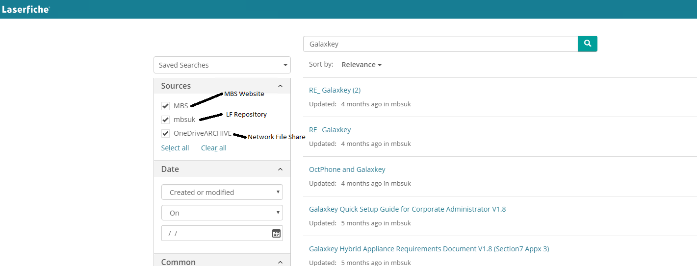

Continuing from this, I've managed to configure a file provider and successfully searched for content from there, but despite adding two local Laserfiche repositories, neither return and results and do not show as a source (assuming they should?)
A colleague is seeing something different on his system in that no repositories appear under the config page but do appear as sources, and yield search hits along with his other configured sources (web and file).

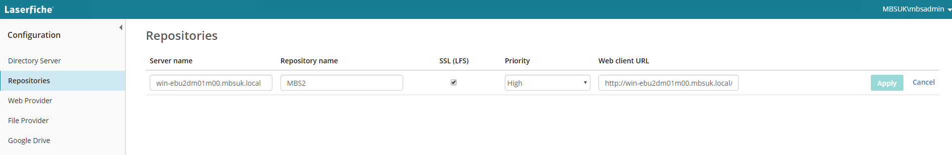

Hi,
The behaviour of the config page allows me to enter the details for the repository but clicking apply the button disables as though its doing something but then does nothing.  No indication its adding the repository and you can navigate to another part of the config.
Returning to the Repository Tab and nothing again is showing but as Nigel said, the repository is being searched within the Federated Search Client.

    3. In the first screenshot the repo name is MBS2, while the name in the second screenshot is mbsuk, are they the same repository? Did you add mbsuk before?
    4. To make sure I understand your words, when accessing admin site, you see no repositories, and the first screenshot happened after you clicked the "Apply" button?

Correct,  No repositories show and the line MBS2 is my attempt to add a new repository and when clicking the Apply button, it disables and does nothing else.
The MBS2 is a second repository I want to add to the RepositoryProvider that I created yesterday as a test.
Im using and have tried Chrome and IE both installed on the server.
