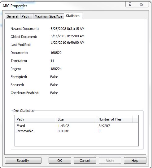

replied on February 21, 2018
(please don't post the same question more than once)
The administration console can give you statistics on each volume:
Just right-click on the volume and open its properties. Depending on the size of the volume, the statistics may take a bit to calculate (and the dialog may look frozen in the meantime).
