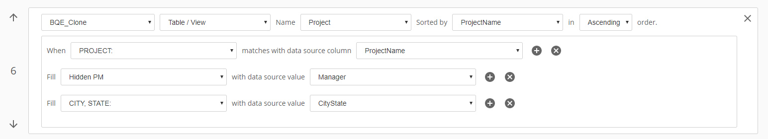

Here is my lookup rule
The user selects a Client in the Client field, which pulls back a list of projects associated to that client.   They then select a Project, and that pulls back the PM and City, State.

So if I use this code, targeting the Project Field, it makes that field blank and I have reselect the project.  That isn't what I am going for though.  I want to leave the project as is and just have it update the PM.  Any tips?
Force lookup of hiddenPM <--Doesn't seem to wok
$("#q4 input").attr("vo", "e");
replied on February 14, 2018
The Value you should put in the place of the "#q4 input" should be the HiddenPM field which is the one you want to update, not the lookup field.
If #q4 may also need to be replaced by #Field4 which again would represent the HiidenPM field
Thanks Steve!  The combination of using input instead of \\(1\\)  and targeting the correct field get me to my goal!
