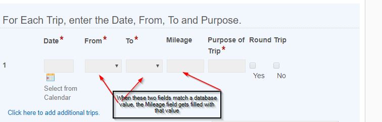

I have field called Mileage that gets filled in with the miles it takes to get from one location to another.
What I have added is a checkbox field labeled Round Trip with a box for Yes and No.
When the submitted selects the "Yes" checkbox, I need the Mileage field to multiply by 2.

I have also attached a screen shot to show what the fields look like filled out.

replied on February 14, 2018
Jared,
My apologies as I labeled my screen shot wrong. I have updated the screen shots to better help explain.

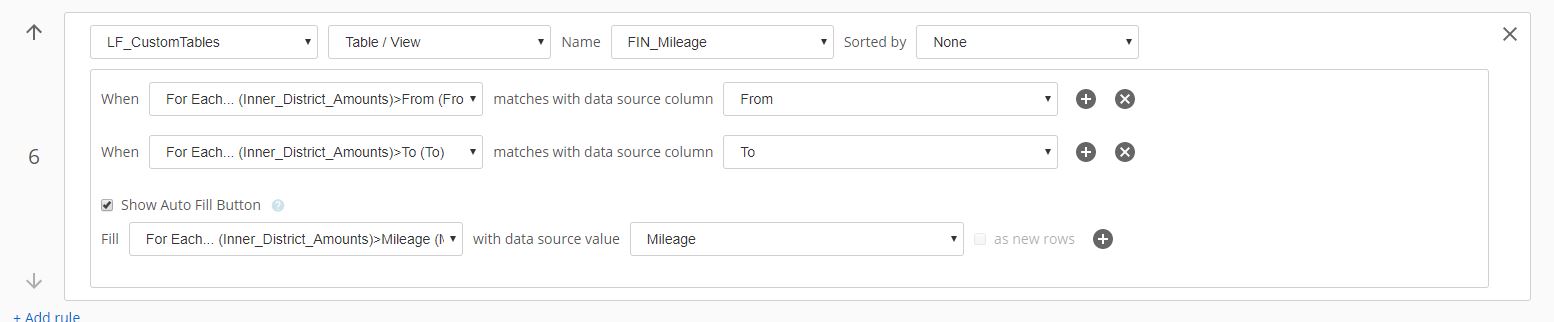

What is happening is that there is a look up rule that fills in the Mileage field when the To and From fields match a value in the database table being utilized.
So in reality, It would more like, whatever the value of the Mileage field is times 2.
Thanks!
Oh, then I might use a hidden field. You have your To and From fields, do the lookup and store that in a hidden field called Initial Mileage or something. Then the calculation for your showing Mileage field would be
IF(Inner_District_Amounts.Round_Trip.Yes,
Initial_Mileage * 2,
Initial_Mileage)
The hidden field will store the lookup value, then the showing field would either show the hidden lookup value times 2, or just show that value as is.
