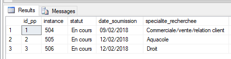

This is my database

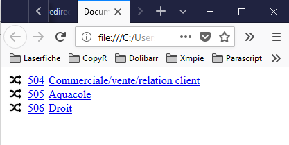

And this is what I want

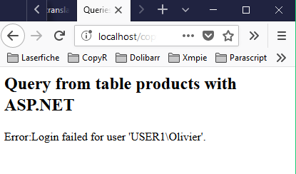

This is the error
The login is correct! I use it with Mssql Management Studio with no problem.

I'm not sure you can do Windows authentication by putting your domain credentials in the connection string.  You may need to create a separate account that can authenticate with a password.
replied on February 12, 2018
Brian is right, even from SQL Studio you can't just enter domain credentials into the user/pass inputs when working with Microsoft SQL. Create a SQL user.
Also, database connections work best server side, you can use PHP to execute server side code instead of running the code in the client browser. This also prevents any of the authentication information from being available to the user.
replied on February 13, 2018
The script block is "runat=server", so it is executed while rendering the page server-side.  Only the data within the Response.Write calls is sent back to the browser.
replied on February 14, 2018
Ah, good deal. Didn't know VB had that option.
Thank you Brian, it's working with a new login.
