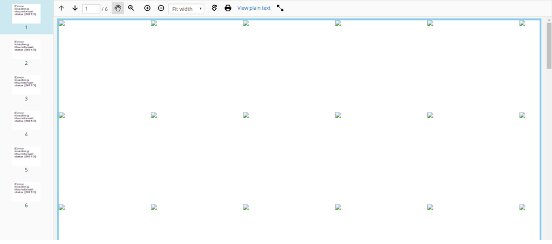

I have multiple clients reporting that after upgrading to LFS 10.3 their Weblink has been having periodic issues rendering the image and populating thumbnails.  It has been reported by customers that upgraded to WebLink 10 as well as those still running WL 9.0.1.
Below is a screenshot of WL 10 showing the problem:
Any suggestions on how to resolve this?

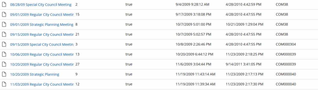

I was working with one of our clients this morning who was having the issue.  We noticed that the Volumes for documents that we weren't able to view were different than for documents we could view in Weblink 10.
We determined that the "COM38" volumes were from before they did an upgrade of Laserfiche back in 2009.  The current volumes "COM000039" are the current ones documents are being stored in.
So as a test, we migrated one of the "COM38" documents into the same volume, which updated it to "COM000039" and then we were able to view the documents via Weblink.  We continued migrating documents and folders in the same fashion and found that it fixed our issue.
