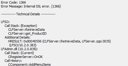

What error do you get?
replied on February 9, 2018
This is the error that I get

Also when connecting without checking use SSL, I still get this error.

Thanks for checking into this. I did not know that the LFS service was tied to the SSL bindings in IIS. I thought it just randomly choose from the personal store because of the requirement to put the certificate in the personal store. It was bound to the certificate but while looking at the binding I noticed the SSL certificate expired! That was the problem. I got a renewed certificate and it works now. It just never prompted me that it was denying it because of the expiration.
