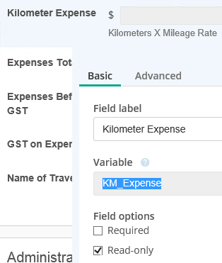

Yes, the fields are "Read-only" which is supposed to be fully supported in 10.2???

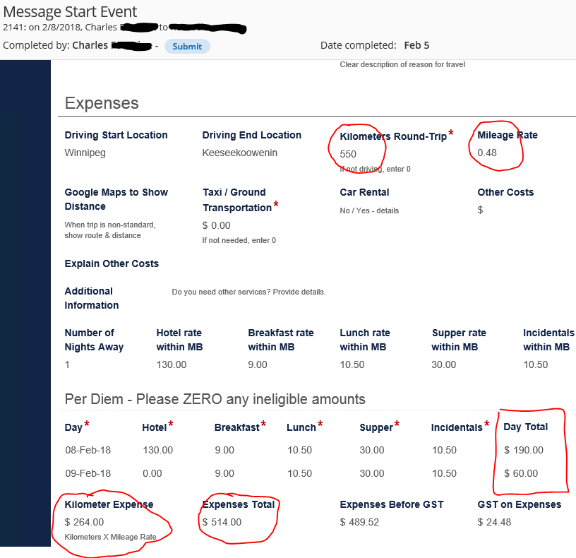

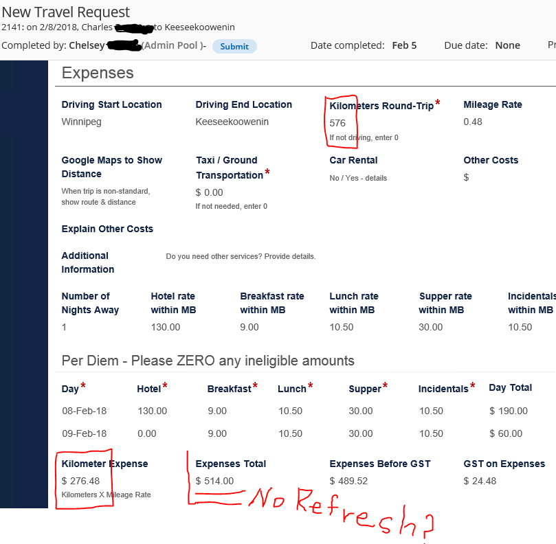

Message Start Event Screen. Note the value of 550 KM @ 0.48 = $264 for travel distance resulting in a TOTAL EXPENSE = $514  which is generated correctly by the =SUM function shown in my original post
At Step 2, an Administrator reviews this claim and corrects Charles' KM value to 576 KM which updates the Kilometer Expense variable correctly to $276.48.  We should then see this 12.48 increase reflected in the EXPENSE TOTAL which SHOULD HAVE increased to $ 526.48.  Instead, the Expense Total keeps its original value of $ 514 .
We see this failure to refresh some calculated value happening about 5 times out of 100 and the customer is losing faith...

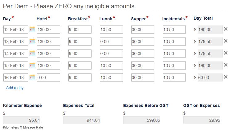

Here's another where the Expense Total updated but the 5% tax calculation is frozen with an old value of 599.05 and did not refresh to 899.09 when the Total increased to 944.04.
