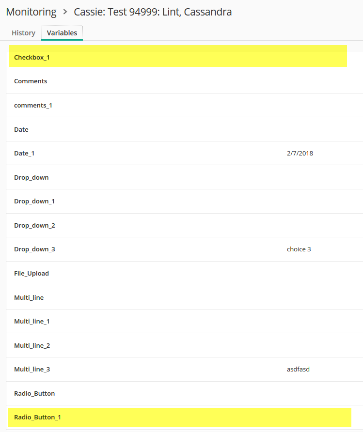

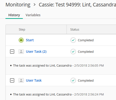

replied on February 12, 2018
Hi Rui - the value is showing blank after submission for both radio buttons and check marks actually.
Here is one of the instances:

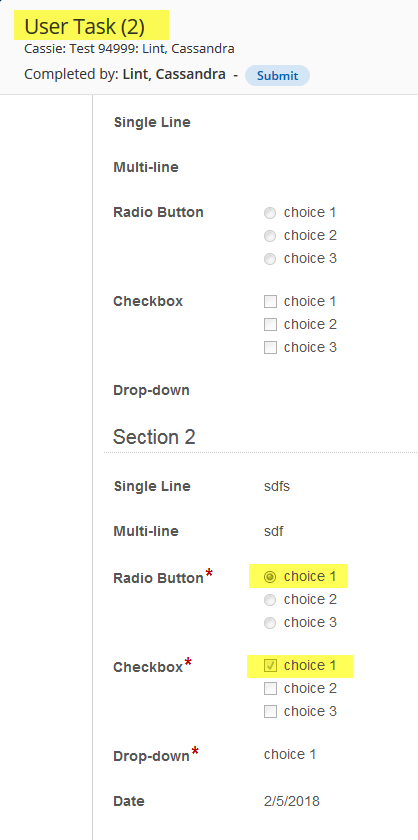

In the first task, I selected "choice 1" in Section 2.

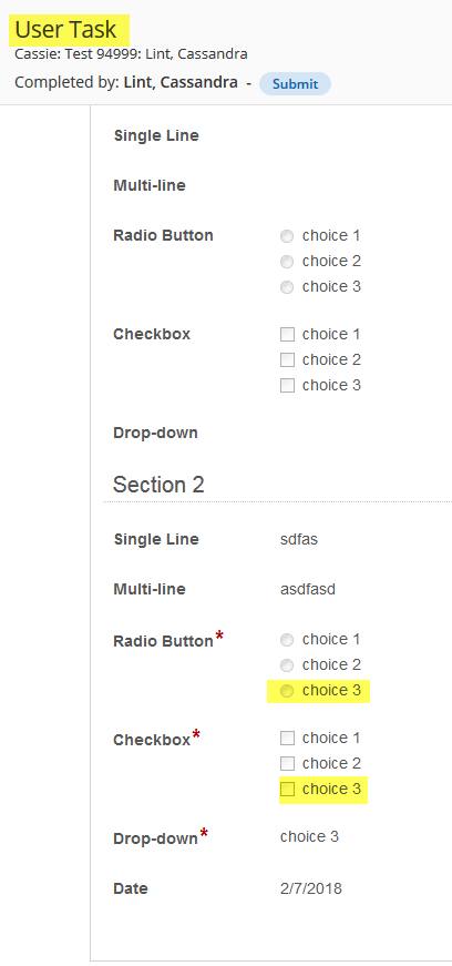

In the next task, the javascript clears all fields in Section 2 on document.ready(), then I selected "choice 3" and it allowed me to Submit the form, but doesn't save the selection.
Instance Variables:
