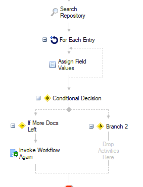

Maybe you could recreate it on your end. The WF is simple. Search > Add entry ID to an independent field > if there are more than zero search results, then call the WF again:
I made it a business process and it uses the folder selected as the path to perform the search, so I can limit the scope. If you run a couple at a time, you'll see the duration of the Assign Field Value task getting longer within a few minutes.
I did it using a Find Entries activity instead of a search as well. Same issue, but find entries finds all docs, which can be a lot in some cases. The search can be limited on its results it returns.
