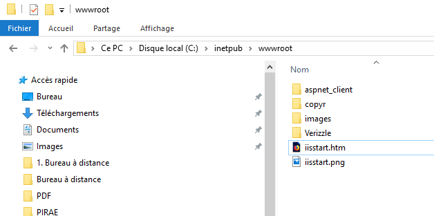

The Physical path is "C:\inetpub\wwwroot\quickfieldsapi" but I don't have it.
How can it possible and how can I resolve it?

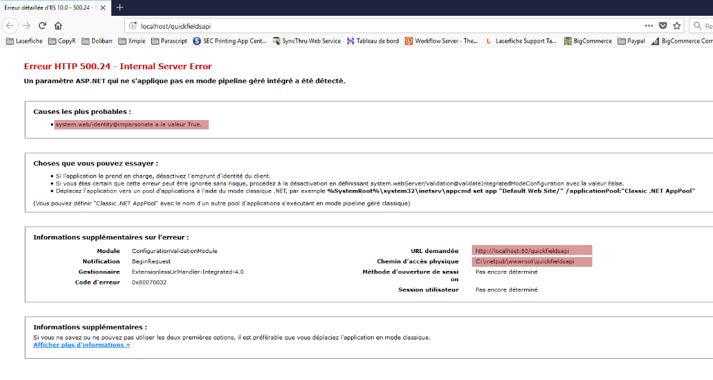

replied on February 5, 2018
Hi Miruna,
thank you for your return.
My QF Server service is running...
...and this is the error message.
I don't really understand the error's message but it looks clearly the path access is "C:\inetpub\wwwroot\quickfieldsapi".
replied on February 19, 2018
Hi Oliver,
The Admin Console URL is http://localhost/quickfields,  not http://localhost/quickfieldsapi. If you want to look at the QF Server API directly you'll have to specify its port, like http://localhost:8093/quickfieldsapi.
Additionally, based on how you configured your QF Server, you may have to use your server name instead of "localhost", e.g. http://<servername>/quickfields
