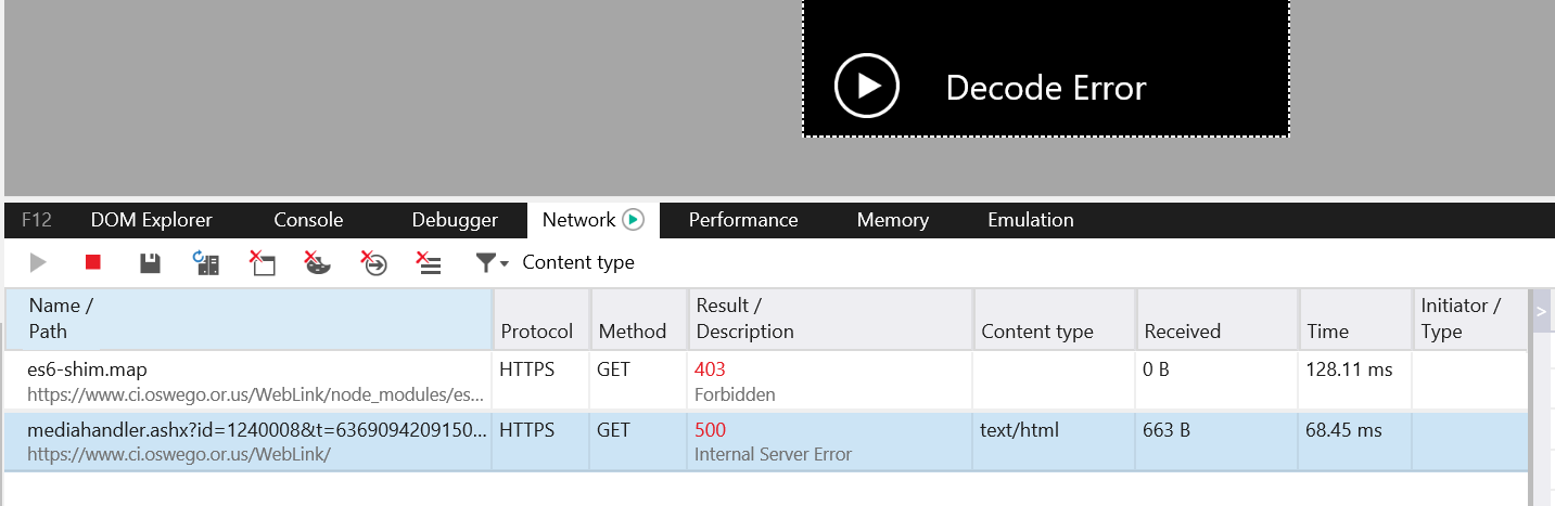

F12 on the the loading of the Video in IE, throws two errors:
403 Forbidden and 500 Internal Server Error:
replied on April 16, 2019
I think that media handler 500 error is the root cause of the video not playing, though I don't think the stack trace you found in the event viewer is related.  I'd suggest opening a support case so we can take a closer look.
