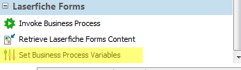

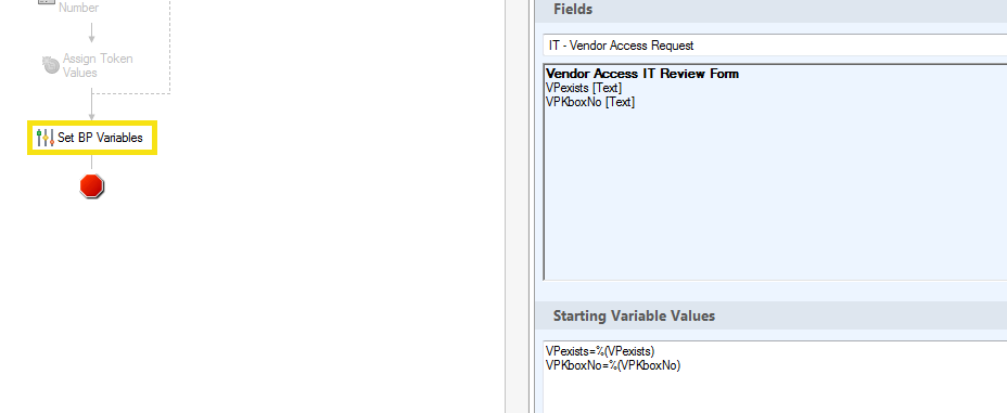

It sounds like you will want to look at the "Set Business Process Variables" activity in Workflow.
Example from a test Workflow that at the end, updates the Form process it was called from.
This should get you on the right path :)
