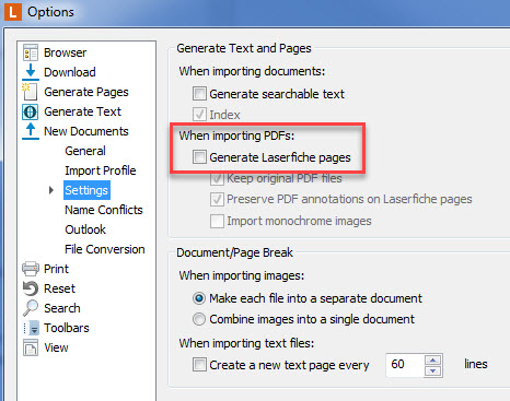

On the 10.2 upgrade Forms now tried to automatically generated pages from PDFs when it is imported.  Unless it is essential for you to have the pages generated, try turning that off in client/Web Access (whichever you are using) and try importing again.  Upgrade notes say that this feature is dependent of having the generate pages turned on.  Unfortunately this is a user by user thing so whoever is importing with the form will need to make the change to test it.
Under Options - New Documents - Settings make sure the When Importing PDFS: Generate Laserfiche pages is unchecked then try importing again.
