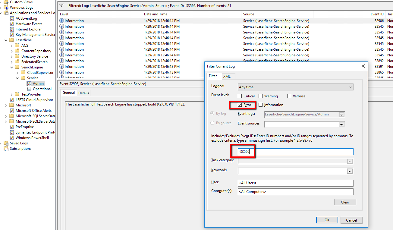

"The TextProvider process was terminated due .." should not be related to the issue. Please check event logs by following steps:
1. On LFFTS machine, open event viewer and go to Application and Services Logs/Laserfiche/SearchEngine/Service/Admin
2. Filter log to include error level events and exclude event id 33566. (See Filter.logs.png attached). You may exclude more messages if needed.
3. Check the error messages, there should be messages indicating the failure reason.
If there is no useful message after filtering the event log, please increase the maximum log size and choose "Archive the log when full, do not overwrite events" in Log properties (https://msdn.microsoft.com/en-us/library/aa754305(v=bts.10).aspx) and restart Laserfiche Full-Text Indexing and Search Engine. Check event log if the issue still exists. If there is still no useful messages, please file a support ticket with LFFTS event logs and the excluded event ids.
One possible guess might be insufficient disk space. If it is the case, re-index / Create a whole new search Catalog may not help.
replied on January 29, 2018
Hi Cangfei,
I have just done this filter and found the following: (screenshot attached)
Last week Friday, I done the following:
1. Stop the Services
2. Change the search folder from SEARCH to SEARCH.OLD
3. Restart the Services
This created a new search Folder for me, but of course all the documents now that were Search Textable are no longer there as the old Search Folder contained all the data,
I can also confirm:
* The HDD still has over 60GB of Space remaining.
* The user running the service is full Administrator user
So, I am not sure why it would advise it is failing to modify the read-only search catalog.
thank you
Ziad

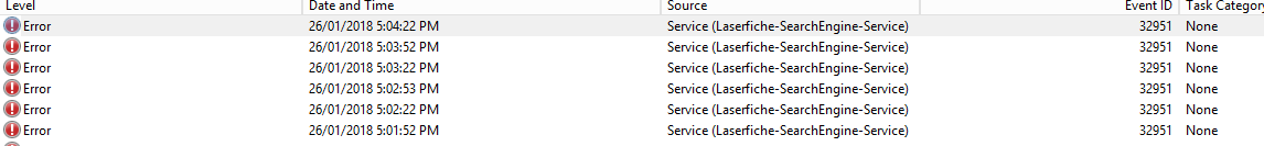

replied on January 30, 2018
The info is not enough for troubleshooting. There should be messages indicating the failure reason. It is not easy to find them because there are many duplicated messages (Event ID 32951). Please follow the steps in previous post to filter the event log to exclude the message 32951. If there are other duplicated messages, please exclude them in the same way until you find useful messages.
If there is still no useful message, please do the 2nd part in previous reply.

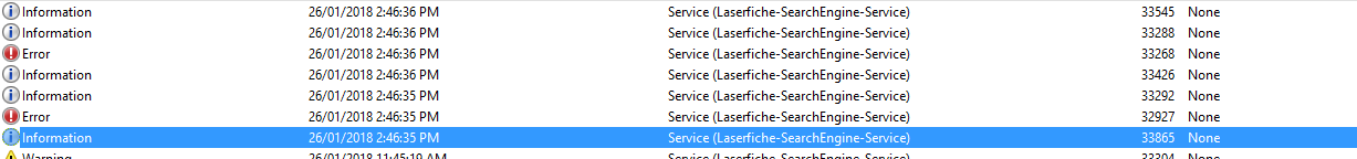

Hi Cangfei,
Here is what i found after the filter was put in place:
The information highlighted is giving me the following:
Operation: TRACE, result: WordTree.cpp:368. Please ignore this message if there are no other error messages. No user action is required.
The error above it:
Fatal error encountered: 0x170c000809f.
The error above that:
std error: abort, Search catalog "RepositoryName" will restart.
Which then advises me that the SearchCatalog is restarting, then stopped and a warning of:
.IDX files for the search catalog "RepositoryName" have been rolled back.
Thoughts?
Thank you
Ziad
