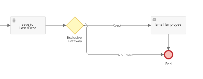

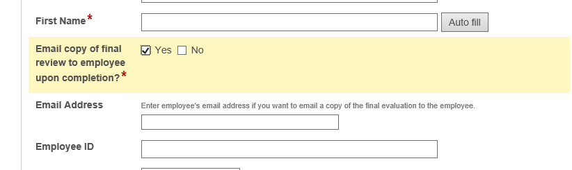

I'm assuming the supervisor fills out the form initially. On that initial form, include a checkbox
"Email copy of review to employee upon completion?"
If checked, I'd then use a field rule to show an email field telling the supervisor to fill in the email address of the employee being reviewed. If the employee's email is already on the form, you don't need to do this step, just the checkbox to indicate this form should be emailed.
Now that the performance review has been submitted, it will be routed through your process. At the end, you can use a gateway that, if the email to employee checkbox is checked, goes to an email service task and sends the form to the employee email. If the checkbox isn't checked, the process will just end there.
Something like

APPROVED ANSWER
replied on January 25, 2018
Something like

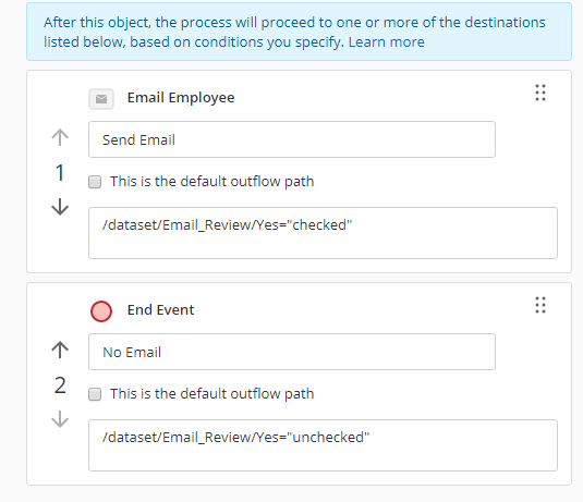

Hi Jared - Sorry to bother you again. I followed your instructions but the exclusive gateway gets terminated. I think I need an outflow condition?
replied on January 26, 2018
Yes, for the top branch you'll want a condition stating
Email_Review Yes checked  (Where Email_Review is the variable for the checkbox field)
The bottom would be the opposite (or you can just set it as default)
Email_Review Yes unchecked

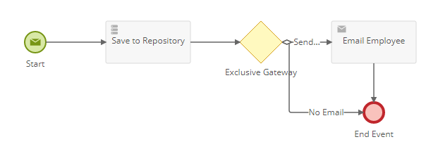

Hi Jo Anne - This was a pretty complex process diagram. Basically the approval workflow is as follows:
Initiator (Evaluator) > Supervisor (up to 3 tiers) > Director Approval > Back to the Evaluator to conduct the evaluation with the employee and employee signs > Director Final Review (so he/she can read any comments the employee may have submitted) > Employee Personnel File.
Any person may reject the form where it goes back to the initiator for whatever reason.
I set up an email service task where the final form is emailed to the employee if the box is checked on the form and the email address in typed in the field. See below process diagram and how the form looks.

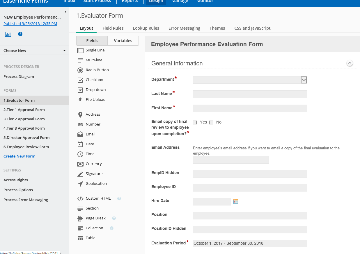

replied on April 11, 2019
Dear Jo Anne -
I took some screen shots of the form. I don't think this will help you very much. See attached. Note that I had to create 6 forms for all the different approval levels. The last form which is the employee review form has a signature box for the employee to sign. They sign the form electronically using a Topaz Signature Pad. Or, they can just use the mouse. This was a difficult form to design because of all the possible approval levels. How many do you have? We have up to four. If the form can go straight to the director, the evaluator selects that it is ready for director approval then the director field shows up. There are a lot of field rules in the form. Do you have an account manager? Is your Laserfiche through MCCi?
