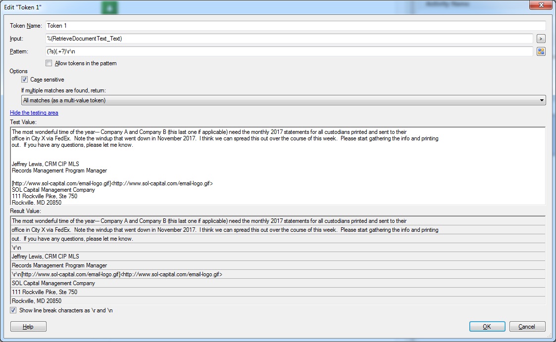

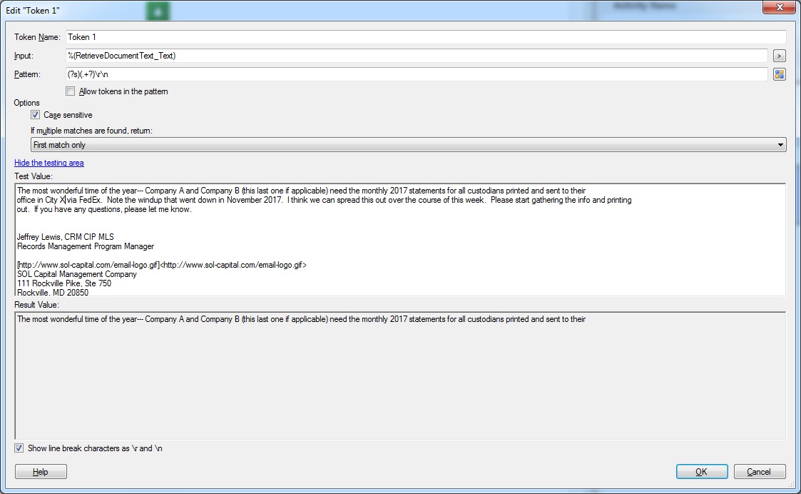

It's interesting, when I put that into RAD Software Regular Expression Designer it worked, but when I put it in my workflow it didn't work.  That RegEx in Workflow gave me only the first line and didn't give me all the data until the line break.  I was able to tweak and replace the \r\n with the company name because that will appear in the e-mail signature and that gave me the desired result.  It's slightly more data needed, but it works.
I think the problem has something to do with how the text is OCR'd because if I type it into workflow it works, but if I paste it from the document that is OCR'd in Laserfiche it doesn't work.  I have attached a screenshot of my token editor that identifies the culprit, but why it does that or how to fix it (aside from changing the regular expression like I did) baffles me.
all matches.jpg (195.84 KB)
first match.jpg (142.7 KB)
replied on January 25, 2018
You are right,  OCR text does come back as single lines each ended with /r/n with no paragraph delimiters.  That makes sense for OCR.    The only other option I can think of, other than using the Company Name delimiter as you are, is just to return the first X number of sentences.
