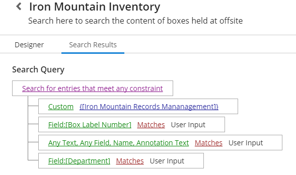

I'm using weblink designer (10.3) to implement some search forms (love it); however, whenever I make a change to the form, it always reverts back to "Search for entries that meet any Constraint" even if I've previously had it to "all constraints". This is a problem, because I need it to keep the constraint applied that it search one template in particular. Not sure if this is a bug or not...

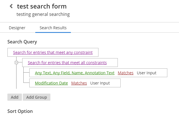

2) Set an additional group under the "Search for entries that meet any constraints" with "Search for entries that meet all constraints" and that will retain the UI settings as well.
