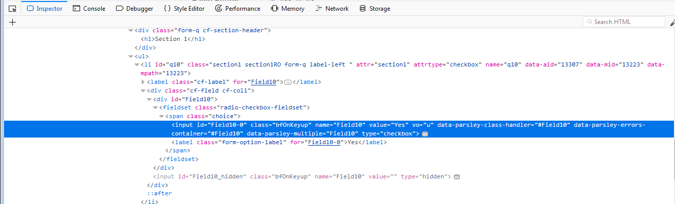

Thanks to Jason Smith's help here I was able to get my form sections to hide based on which process step they were on by using Javascript to check a field. Now I need to know how to mark a section (or all the fields in that section) read only using Javascript. I'm not familiar with Javascript so I've just been trying different examples people have posted that relate to this but can't quite get it working. I've marked the section and all fields within the section with css class "section1RO". I've tried the following scripts and the best that happens is the text field will be readonly but not the radio, check mark or drop down fields.
If anyone knows what I can do with this script to get it working or where I can find resources that talk about the differences between test/radio/checkmark/dropdown fields and their attribute/properties?

I wasn't able to get this code to work. The "section1RO" class is actually set on all of the Section 1 fields so I created a new class only on the Section 1 section and changed line 07 to match that class but I couldn't get it to work. Then I tried changing 'readonly' on line 15 and 18 to 'disabled' (wasn't sure if I needed to change 'backend-readonly' to 'backend-disabled' as well?) but that was a no go too.
I was able to use this code to work but it's not as scalable as what you suggested. I'd really like to figure out what I'm doing wrong with the code you suggested as it would be much more helpful on scalable projects than what I have below.

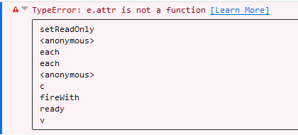

Hi Jason,
The sections showed correctly but Section 1 is not being tagged read only.
Browser console shows this error:
This is the code I'm currently using:

Hi Jason,
We were able to get it working using this:
replied on January 29, 2018
Okay, so it looks like those types of inputs need the "disabled" attribute to be treated as read-only. That being the case, I would update the "remove read-only" portion of the code to also remove the disabled attribute otherwise it will not work correctly to make fields editable again.
