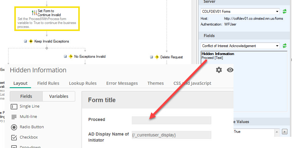

Someone might come back and say you can script it but I can't script.  So my first thought would be to put a step before the email that starts a workflow and wait until it is done before moving on, pass the values to the workflow to sort and pull out the needed information, then pass it back to the workflow.
I have a process in forms where I have to verify if the person submitting the form is on a specific list.  At the point the form is submitted, I have it go to a workflow to pull the form information.  I use the information to check the list, then I pass a variable back to the form and the form splits based on the variable.  I also have a separate form (not the one the customer sees) that holds any "background" information I gather on the form or from workflow.
You could "compose" the email as a token in the workflow then pass it back to a multiple line field and when sending the email just the multiple line field as the token.

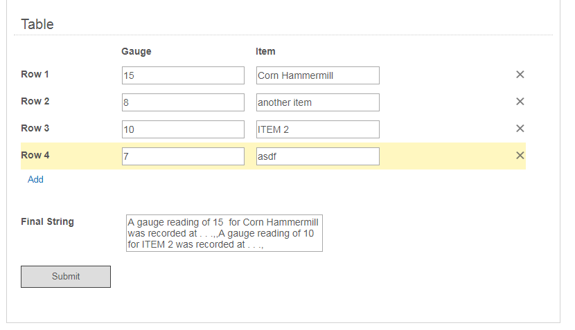

Here's an example that may help. I may not have fully understood your gauge/item use case, but hopefully you can use the concepts to build it out how you'd like.

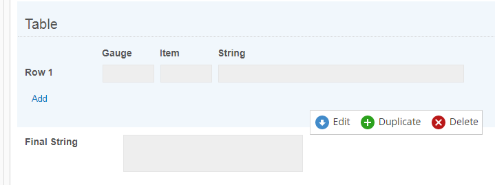

I have a table with columns for Gauge, Item, and String, and then another field outside of the table for Final string.
Opening up the table field options, then going into the String field options, I used the formula:
=IF(
INDEX(Table.Gauge,ROW()) >= 9,
CONCATENATE("A gauge reading of ", INDEX(Table.Gauge,ROW()), "  for ", INDEX(Table.Item,ROW()) ," was recorded at . . ." ),
Saying IF the value of gauge for each row is greater than 9, create a string reading "A gauge reading of GAUGEVALUE for ITEMNAME was recorded at..."
Otherwise, if the value is less than 9, leave the string value blank.
Then in the Final String field, I used the formula
=CONCATENATE(Table.String)
to put all the strings for the high gauge values together.
You can use field rules to always hide the string column in the table.
You can see for the two gauge values higher than 9, the strings we added to the final string at the end.
replied on January 22, 2018
Jared, thanks for the visual with this, it helped!  I will have to see how this will work with my use case, but I believe this could be what I need.  Thank you.
