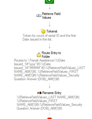

I'm attempting to route an entry to a folder path partly based on a date field, using the year and month as part of the folder structure (e.g. FolderX\YYYY\Month\Last, First-DOB). While this is a MV field, I'm only looking at the first value and will route based on that value.
The folder appears to be routing but skipping the date-based folders entirely, so instead of FolderX\2018\January\Test, AppA-01/01/2000 I'm just getting FolderX\Test, AppA-01/01/2000. I've attempted to create/route the entry with various users that have different access rights/permissions and I can't lock it down to any of those things.

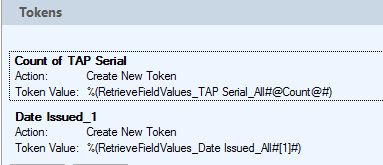

Since you are manipulating the date in the token creation section, are you marking the new token as a date in token tags?

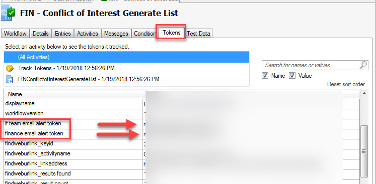

Can you show the set up of your tokens?  If you look at the workflow instance are you tracking tokens so you can go back and see how the token is reading?  The problem might be that the token value stays blank.
replied on January 19, 2018
the Serial count is a string and the Date is a date

What does the history show on a workflow that you have run?  Have you ruled out the possibility that the token is blank (and therefore can't use it in the folder path)?

Jennifer - you're right, the token was blank. But what I don't understand is why. I replicated the Date Issued field as "Date Issued2" and re-ran the workflow using that field. The Date Issued2 token was filled just fine. I guess I'll just update my workflow with the new field.
