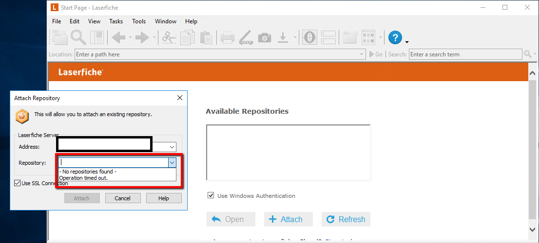

We have problem to attach repository from LF Wins Client. Our Customer require configuration of Kerberos constrained delegation between Netscaler service account and laserfiche server account.
The end-user (LF Wins Client installed) connections go to Netscaler which does pre-authentication and acts as a reverse proxy to the Laserfiche server.
Is this possible to do this?

I'm not aware of anyone who has deployed Laserfiche like this, and as far as I know we don't test it in-house.  When you attach the repository, you enter the Laserfiche server host name, right?  The client should do a reverse dns lookup on the IP address it gets in order to construct the SPN.  When it does this, will it get the lfs hostname or your reverse proxy hostname?  It sounds like you need it to use your proxy's SPN.

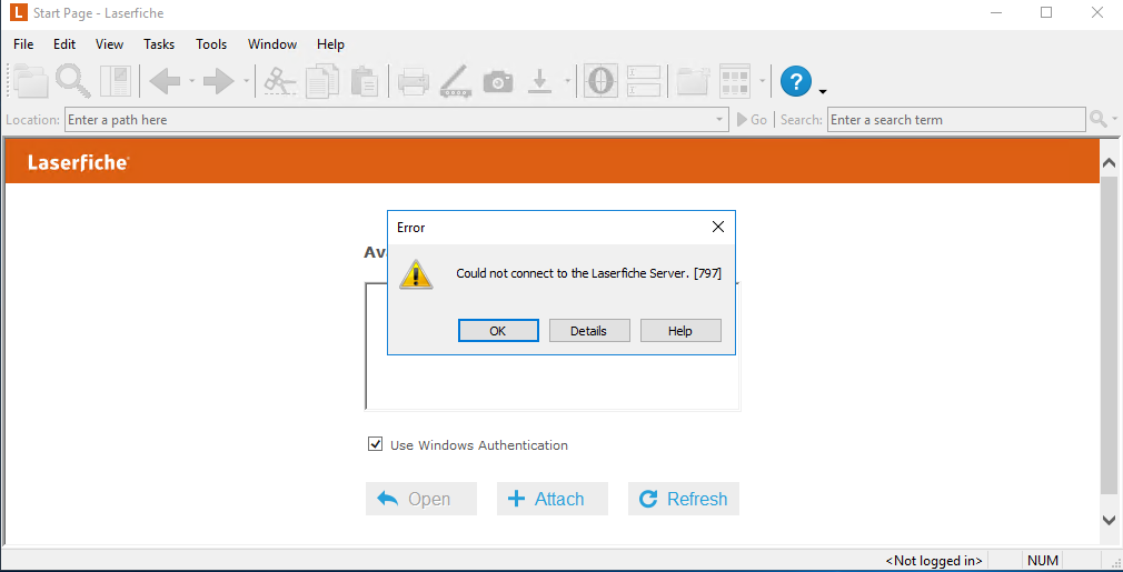

     Thank you for your feedback, we use Netscaler service account (SPN https://laserfiche.xxx.org) which is as publish name of laserfiche server to specify on LF Windows Client attach function.
But it doesn't work.
The error message looks like, it is the right server name but the app could not connect to the Laserfiche server.
Do we have to configure anything on anywhere more?

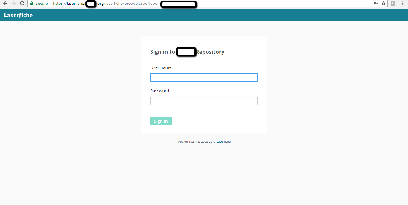

And fortunately, we can connect to Laserfiche web client using the same name.

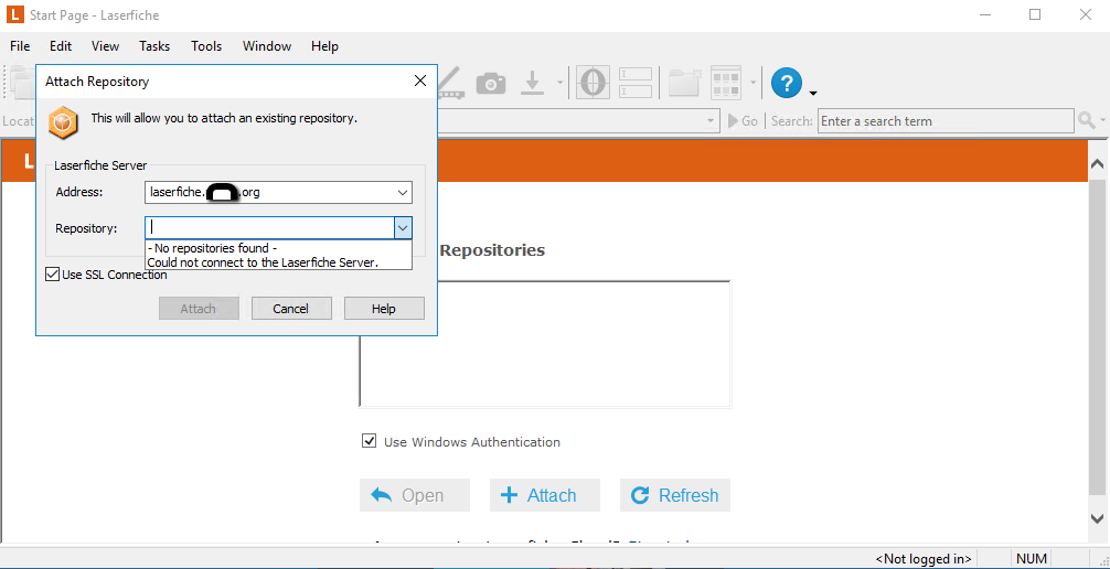

Does the connection fail if you enter the name of the repository?  And does the Web Access connection to LFS also go through your Netscaler device?  They use the same protocol, so I would expect one to work if the other does.
replied on January 22, 2018

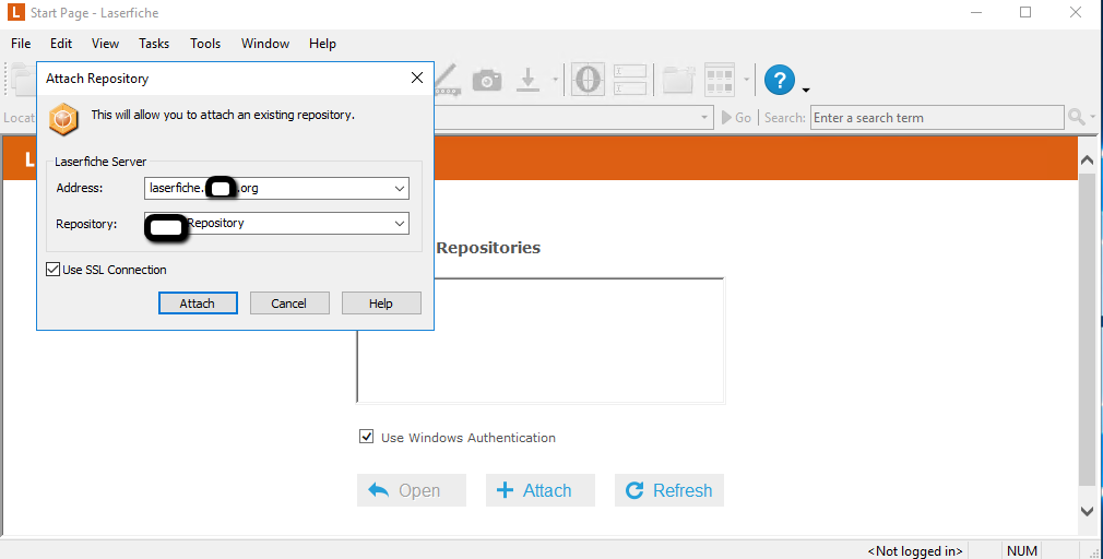

Hi Brain,
It still doesn't work even I enter by the name of repository. But we can connect LFS using the same name https://laserfiche.xxx.org on web access through the same Netscaler.
That why I don't understand that it doesn't get work on LF Windows client.

That error is not an authentication error, it's more of a network connection error, and I don't think your Kerberos settings are the immediate impediment.  Maybe there's more information in your Netscaler logs or you can see more with a network capture.  Do you know if the request gets as far as Netscaler?
When you go to https://laserfiche.xxx.org, is the Netscaler device between the browser and the Web Access server, or between the Web Access server and the LFS server?  If the former, then it's too different from the Windows client situation to really count as a success to compare/contrast against.  Do you know what I mean?  It's good that it works, but it's not relevant from a troubleshooting perspective.
I'm not sure Laserfiche support can really help you.  It's the introduction of the Netscaler device that is causing the difficulty, which means that your problems are with either Netscaler or the network configuration it requires.  In general we know that the Windows client is compatible with a reverse proxy.
