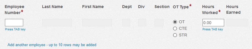

I'm trying to apply this same concept to an overtime calculation in a table:
The idea is that if STR (Straight Time) is selected the multiplier should be 1.0, if not the multiplier is 1.5, so my "Hidden Multiplier" field calculation might look like this:
=IF(Group_OT_Details_Post.OT_Type_Post.STR,"1.0","1.5")
However, I can't figure out how to employ this in a table. I've tried both creating the Hidden Multiplier as a separate field outside the table and also as a hidden column in the table, then tried various PRODUCT calculations in the Hours Earned field, such as:
=PRODUCT(INDEX(Group_OT_Details_Post.OT_Hours_Worked_Post,ROW()),HiddenMultiplier
All of the variations I've tried either do nothing or show a calculation error.

Thanks very much for taking the time to answer, but I am still getting an error. It seems to not like multiple uses of the hours worked variable?
replied on January 18, 2018
Ahhh... that may be why someone said to use a hidden field. Both of the answers above are correct, partially. They work fine if you select one of the radio buttons first, but produce an error if you fill in the Hours Worked field first. There may be a way to determine if none of the options are chosen and set the value of the Hours Earned to 0 or leave blank, but I've tried a few things and none worked.

I used the OR, but it didn't work for the radio button field. I checked that field for "", NULL, null, and a variety of other values. I also checked that field for each of the options (OT,CTE,STR) in the IF statement, but I got the same error message for each. I think the issue has to do with the radio button group not being set to a value. If there's something like a "IS SET" type of comparison operator, then maybe an IF statement will work. Let me know if you find a formula that works.

I believe the radio button is throwing an error if a value isn't selected, causing an error  in the Hours Earned field. There are a few options that I could find to get this to work: 1) You can add another radio button option that says "None" and make it the default and account for it in the calculation. 2) You can use a dropdown list instead of a radio button with a "None" or "?" option as the default and account for it in the calculation, or 3) you can add an extra hidden field to your table that gets the value of the selection and use that field in the calculation.

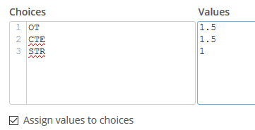

In the mean time, I am thinking that Susan could have made the "OT Type" radio button (which is variable "OT_Type_Post") assigning the values of 1.5, 1, etc as the value.
I may not have the values exactly right, but you should get the idea.

In the second formula you referenced, the value of the radio button chosen dictates which of the multipliers to use. It's the index number of the 3 values that are separated by commas. So, if I choose OT whose value is 1, it will get the first number in the list. And it doesn't need to be converted it to a number. It works as is.
The third formula you referenced uses a hidden text field to store the multiplier in. You can't store it as a value in the radio button because two of the values are identical. Forms will automatically put a "_1" after the second instance of a value. In your example above, the value for CTE would be changed to 1.5_1.
