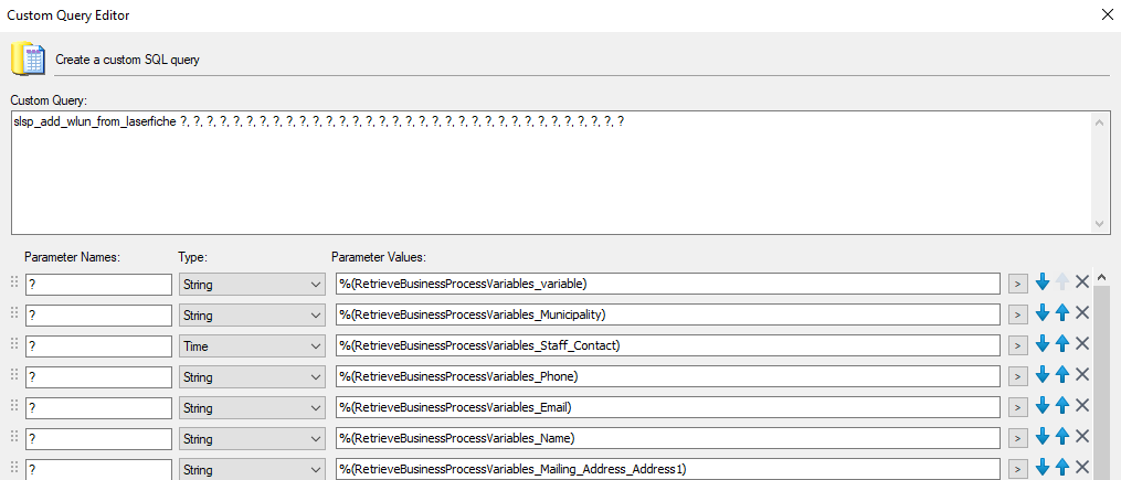

Hello,
   We're trying to execute a stored procedure via a custom query. We have an ODBC connection. We're initiation the workflow via Forms. We pass nearly 3 dozen Forms variables from the Retrieve Business Process Variables tool. When we run a test form, we receive an error stating: "ERROR [42000] [Microsoft][ODBC SQL Server Driver][SQL Server]Incorrect syntax near '@P2'."
   We've done this on other Forms/Workflow combinations just fine. However, on those we were only passing one variable via the stored procedure. I'm a relative novice when it comes to SQL, so I'm not even sure we're doing it correctly. Perhaps we're using the wrong separator between the variables. This is an example of what it looks like: stored_procedure_name ?, 'variable 1', ?, 'variable 2', ?, 'variable 3' etc. Is this the correct way to pass multiples?

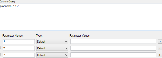

If I am reading your post right there should be no variable 1 or 2 in with the question marks.  Should just be
procname ?,?,?
with the 3 question marks below mapped to their respective variables.

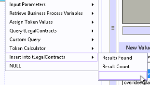

For the return value all you need to do is select it and declare it.
On thing I always have to do though is hit the Test button in the activity in workflow.  Only after you test it do you get the output in usable activities below.  Also, the name always seem to come in blank for some reason.

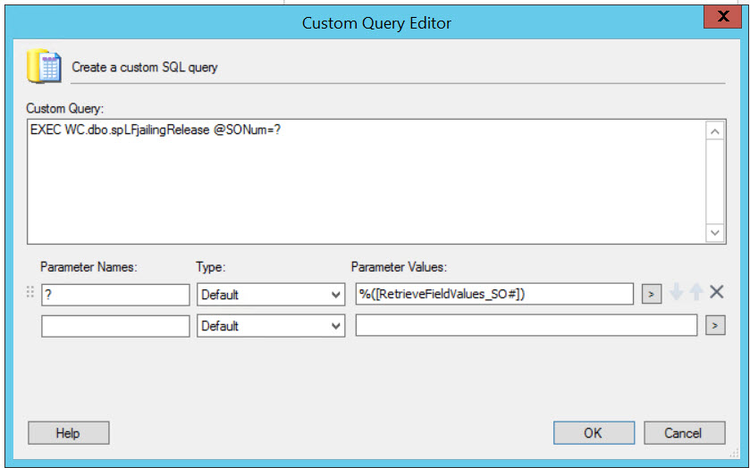

replied on January 17, 2018 • Show version history
I have one working (with one variable). This is it (see attached). You have to make sure that the workflow version and odbc version are the same: ie. 32 bit or 64 bit. Also very important that the data type and length you are bringing in is exactly the same in Laserfiche otherwise it will fail as well.
SONum is the name of the variable in the sql query. I have had that error when my data types did not match.

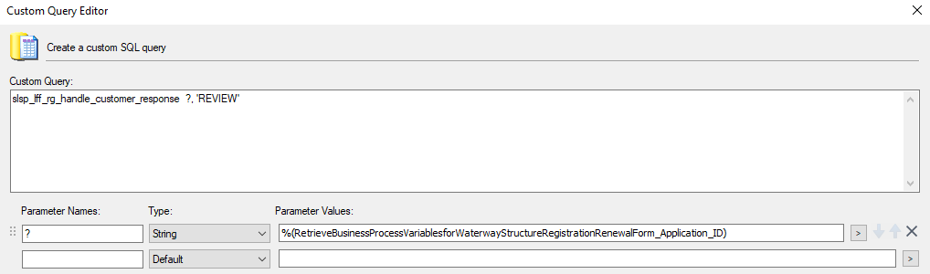

We do have other workflows where it works. But those were only for working with one variable as shown below. That's why I initially built the new one in the same format. This workflow works just fine, so I'm assume that there aren't any compatibility issues between Laserfiche Workflow and the OBDC database.
