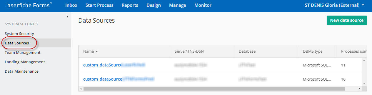

Step 3
Go into Forms administration, and make sure the database associated with your new views/stored procedures is set up as a data source, then link it to the form on which you would like to pull the information.
