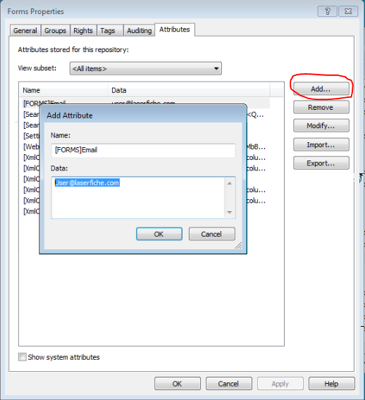

Since this is Avante there is no LFDS, your into would be populated under the Windows accounts in the LF Administration Tool. I don't work with that very often so hopefully somebody else can jump in.
I can give you a workaround to get you to the point you can test
Under the LF Adminstration Tools, Open the user account you want to add an email to and go to the Attributes Tab. Add a new Attribute
For the Attribute name type "[FORMS]Email" and in the data area type the email address for the account and press OK to complete.
Once you have completed this, Synchronize the users in Forms (Forms Admin) Menu. The accounts should update with the Email address from the LF account

replied on September 11, 2019
Olivier,
If this is still an issue I suggest upgrading Avante to at least 10.4 in order to gain access to LFDS.
That way you can import the "email" attribute from AD Directory Services into LFDS.
Steve showed you that you need the email attribute within the console in order to get you to a point, where testing would confirm expectations.
