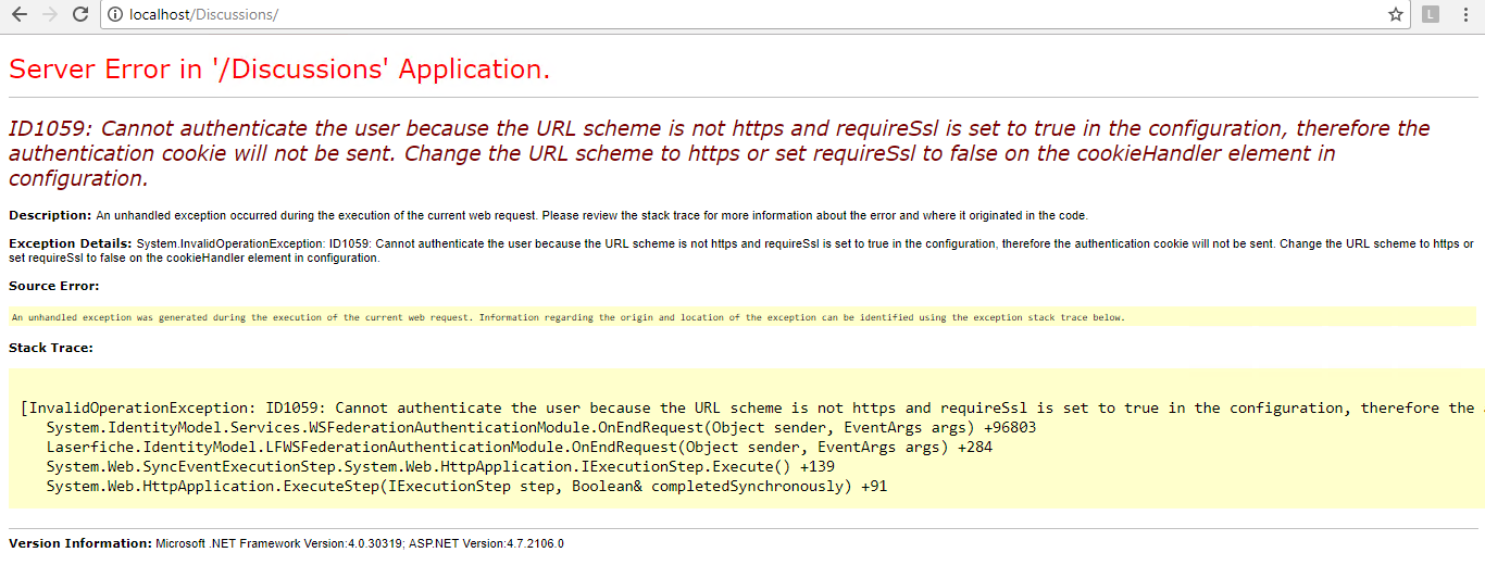

Set requireSsl to false on the cookieHandler element in configuration on LF Discussions
asked on January 9, 2018
I got error a message after configuring in Discussions Configuration and then getting to LFDiscussions.
We would like to Set requireSsl to false on the cookieHandler element in configuration, how could we do that?
Could we use URL scheme as http in LF Discussions?

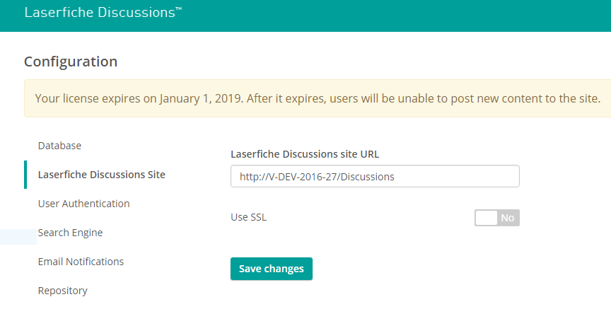

When you configured Discussions, did you set "Use SSL" to "No" in the following section?
replied on January 18, 2018
Hi Leif,
 Thanks for your suggestion.
We have created self SSL certificate and done site binding.
Then the problem solved!
