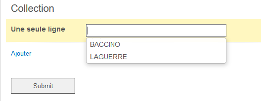

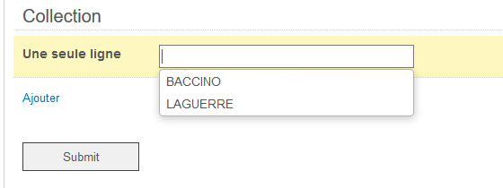

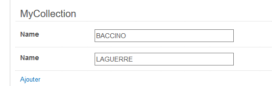

Hi De Wet Van Der Merwe,
I tried to use database but I don't really understand how this could help me.
I created a base "user" (for example) with 2 records (BACCINO and LAGUERRE) and tried to add them in my collection B.
This is what I have.
Or this is what I want.

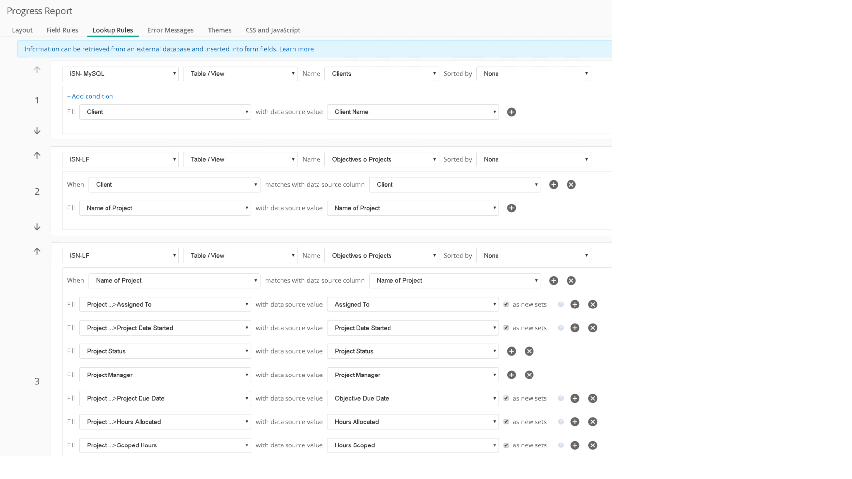

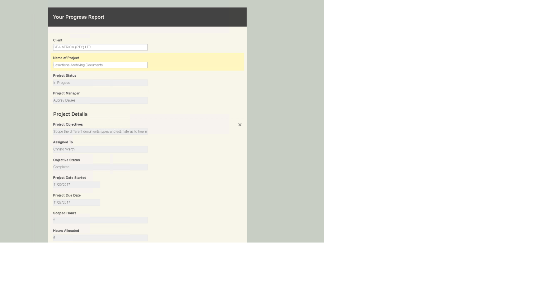

replied on January 10, 2018

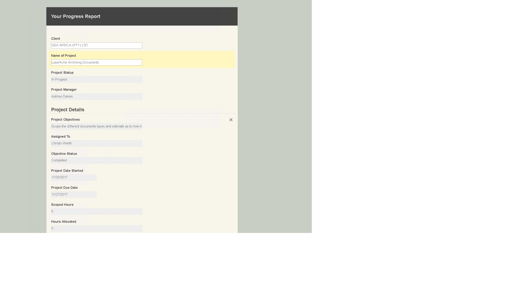

Look at what I have attached.
If you tell me you have built a Workflow that can successfully populate table A with data from form A, the rest should be rather easy.
Don't add your values as suggestions in forms. Add lookup rules!
See attached, let me know if that helps, if not tell me and I will try to check out what you have built.

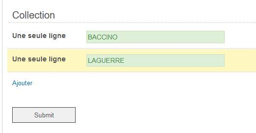

replied on January 22, 2018
Sorry for the late. Thanks for your help.
It's working.
I didn't see that I should check "as new sets"
But, do I really need a database for that?
