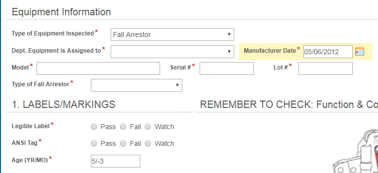

I am trying to calculate the age of a piece of equipment and display as Year/Month.  I am currently using the formula =DATEDIF(Manufacturer_Date,NOW(),"y") & "/" & DATEDIF(Manufacturer_Date,NOW(),"ym").  However, it does not calculate correctly.  It displays months with a negative digit (see below).  Can someone help me fix my formula?

Hi Vanessa
Couple of things I have found
You need to use TODAY() instead of NOW
Also, I have found I can only use the "Y","M", and "D" qualifiers (Year, Month and Day) as MD, YM and YD haven't worked for me in the past
Using this approach, I used DATEDIF to calculate the Years and total months (subtracting the Years (12 months) off of the total months to give you the actual Years and remaining Months as you were looking for
You formula would be
=DATEDIF(Manufacturer_Date,TODAY(),"Y")&"/"&SUB(DATEDIF(Manufacturer_Date,TODAY(),"M"),PRODUCT(DATEDIF(Manufacturer_Date,TODAY(),"Y"),12))
replied on January 4, 2018
That worked perfect! Thank you! smiley
Thanks Vanessa
FYI, NOW() does work as well, I just tested it, same results
=DATEDIF(ManuDate,NOW(),"Y")&"/"&SUB(DATEDIF(ManuDate,NOW(),"M"),PRODUCT(DATEDIF(ManuDate,NOW(),"Y"),12))
