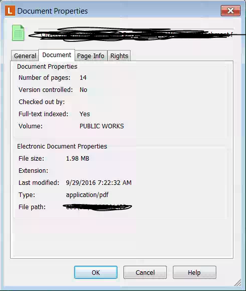

I am currently experiencing an issue due to a previous integration that was not our own. This integration would import documents from one system into Laserfiche. The issue is these documents are PDFs though appear as LF Pages within the client. If we check the document properties they show the document as a PDF with no pages associated with it. If we generate pages the document has pages generated for it and then we can delete the electronic file associated with it. There was an issue with the integration importing the document as a page instead of an electronic document. Since this has been corrected documents are being displayed correctly. I wanted to know if there is a simple way to possibly change a flag to have the documents correctly be displayed as PDFs for these older documents.

Okay, looking at it again, the problem might be the lack of an edoc extension value. If you notice, it has the mime type, but the "Extension" field is empty.
If you can identify the affected documents, you can correct this with SDK scripts by manually setting an Extension value.
For example,
doc.Extension = ".pdf";
The LF database toc table has two separate columns (edoc_mime and edoc_ext); it looks like for whatever reason the edoc_ext was not set.
As a result, the application knows the mime type, but it still treats it like a standard LF document because there is no file extension to tell it otherwise.

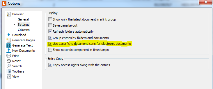

Have you tried bringing in any other PDFs, and are they also affected? Also, did you have errors when you tried opening the documents?
The reason I ask is that client settings can tell LF to treat PDFs like LF documents. I know I have mine set that way so I see the same icon for both PDF and docs with pages.
Again, I don't know if it actually has anything to do with what you were seeing since I don't have all the details, I just thought I would ask.

Unfortunately this is not the case with this. I am able to see both types of files. This was due how the files were imported before using an SDK script. I have verified that that item is unchecked.
For example,

I attempted to change the edoc_ext column since the edoc_mime was correct. When I made the change the icon was changed though the properties remained the same with the empty extension type.
