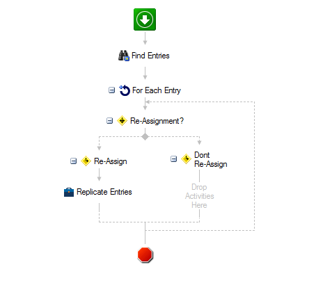

Try changing your logic so its like this
What i'm doing here is retrieving all entries, placing them into a look and processing each one, it checks if the current entry in the loop has re-assignment flagged and if it does it transfers only the current entry over.  Some things to note:

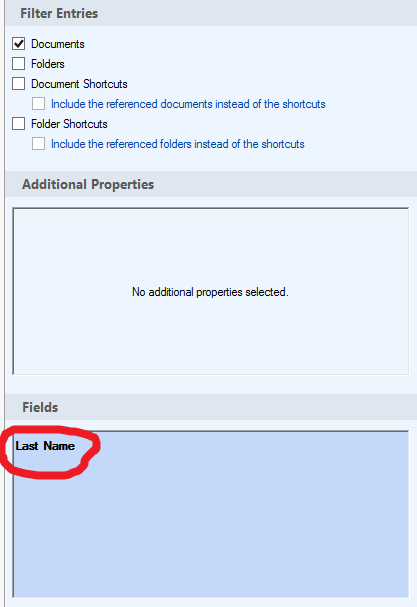

1) Make sure your find entries activity has the field you need selected as so(im using last name instead of Re-Assignment)

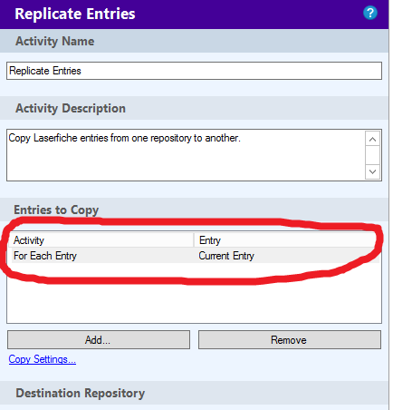

2) Make sure in the replication task you select only the current entry
I hope this all makes sense. Good luck :)
replied on December 19, 2017
This worked perfectly, thanks so much for the directions on how to fix the logic!
