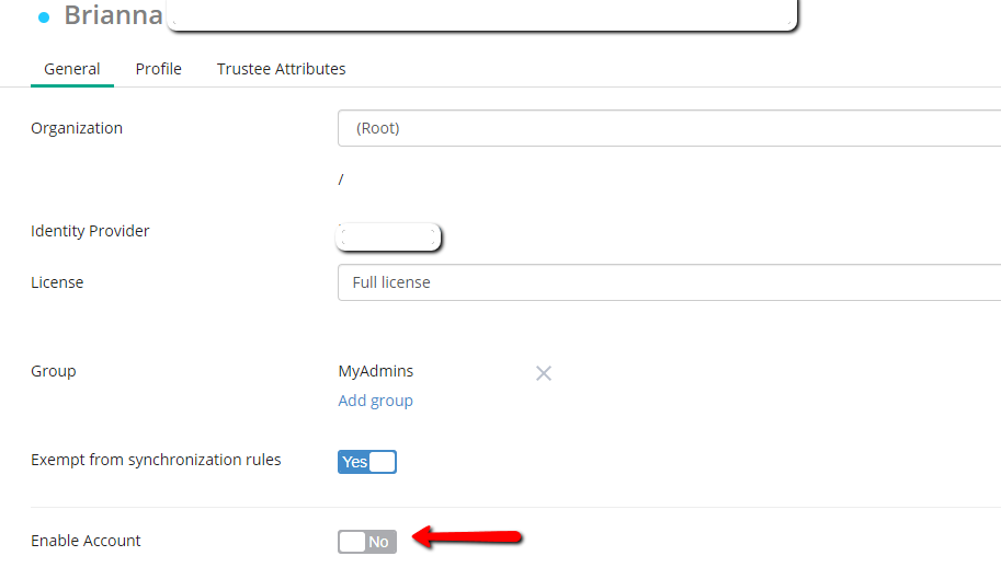

If you are seeing this error on the Directory Server site:
It sounds like someone has disabled the Windows account you are trying to use to access Directory Server. That's this setting here:
The user will also appear greyed out in the LFDS user list. You should ask another administrator to change the setting.

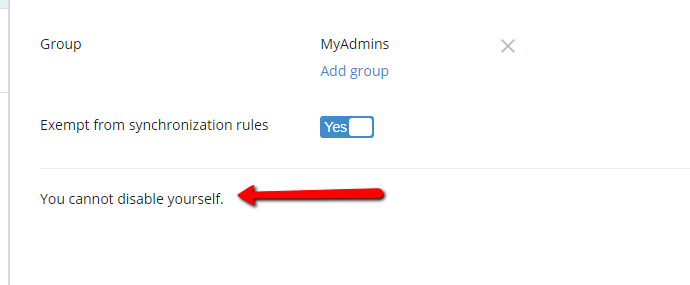

Directory Server should block administrators from disabling themselves:
