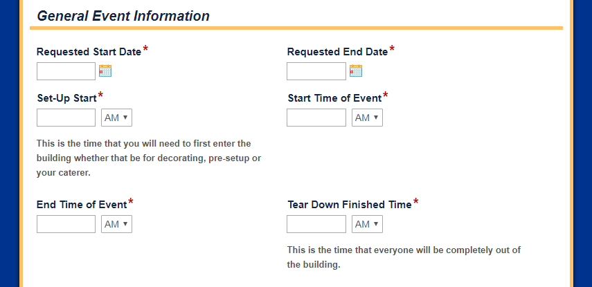

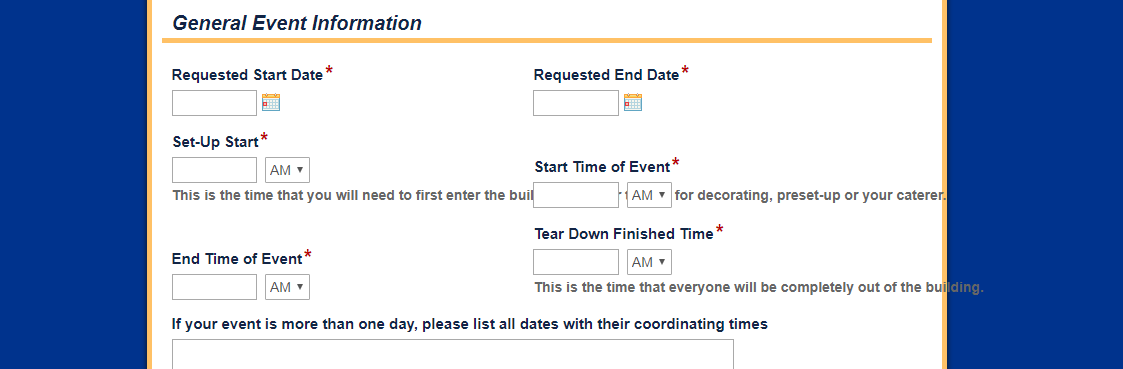

Is it possible to make 'text below a field' wrap, and not run off the side of the form with all text in a straight line?  In this particular form, I have to include numerous time fields, and under some of those, they need descriptions (which are lengthy).  I am trying to make the text wrap and stay under the field I am describing.  Any insight or guidance will be greatly appreciated.  See attachment.

This will make the text wrap, all that's left is to get the formatting the way you want.
.TwoPerLine label {white-space:normal;}
replied on December 19, 2017
Thanks Aaron.  That worked.  I just have to fix the spacing because it moves the other field down at the right of the screen.  Thanks again!

Yes sir, I was!  The CSS @████████ provided worked like a charm.  See snippet for what it looks like now.
Thanks

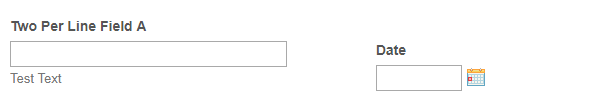

Below is what I'm attempting to solve.
Many Thanks,
Andy

I apologize; I have been leading you in the wrong direction.  I totally forgot that this was what I ran into as well.  I went back and looked at my form again, and what I ended up doing was using Custom HTML fields below the time fields instead of using text below field.  So as you see above, Set-Up Start and Start Time of Event have two HTML fields below them (both with CSS class TwoPerLine) to keep them lined up perfectly.  I done the same thing after End Time and Tear Down.  Let me know if this doesn't make sense, and I will try to explain in better detail.
