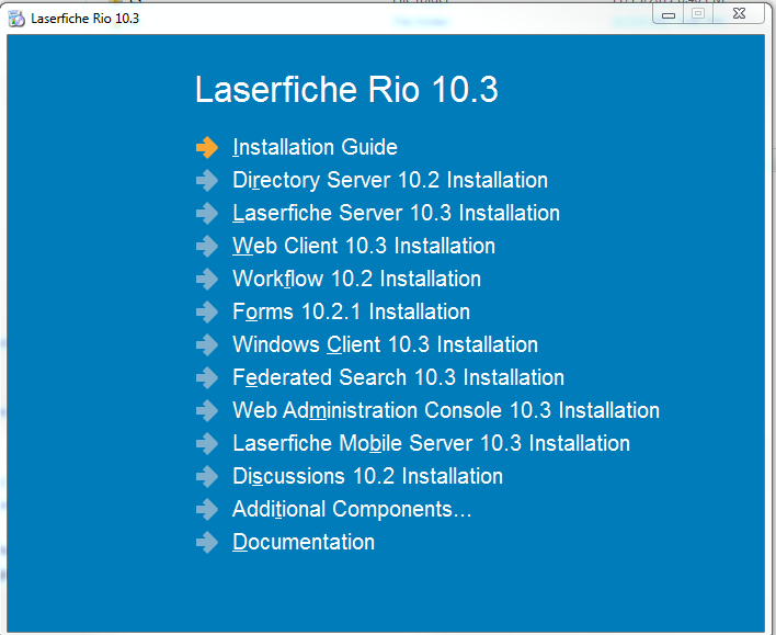

Welcome to Laserfiche!
The install guide is available in the downloaded software:
Or if you prefer a PDF version, take a look at the deployment guide availble from our support site.

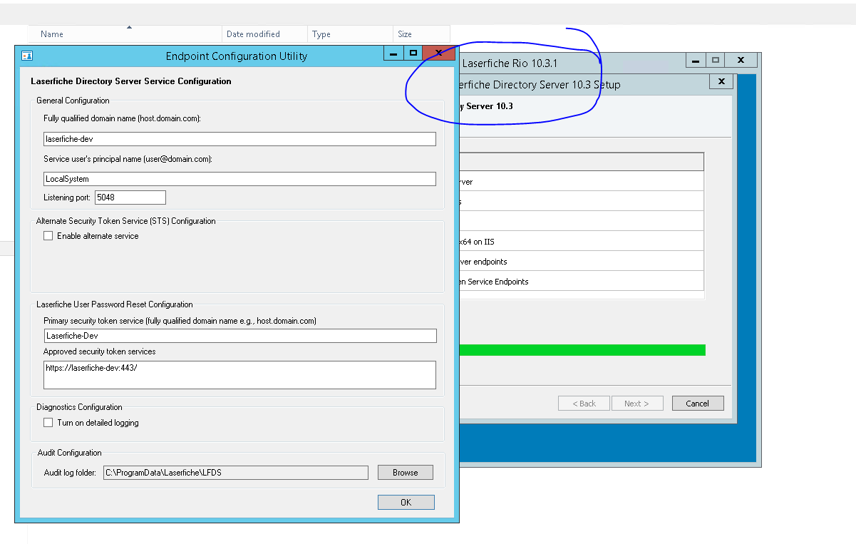

I did note that the LFDS endpoint config entries in your screenshot don't appear correct though:
  1. Where it asks for the Fully Qualified Domain Name (FQDN), you have provided only the hostname. Please enter laserfiche-dev.domain.com, where "domain.com" is the AD domain of the server.
  2. The NT Authority\Local System built-in account is the default identity LFDS runs under. You should leave this field blank so the Service Principal Name (SPN) is set correctly under the computer identity.
  3. Under Laserfiche User Password Reset Configuration, it again has hostnames instead of FQDNs. Update both fields to use the FQDN. You will receive SSL certificate validation errors if what's in the field does not match the FQDN in the certificate.
You can rerun this part of the config by launching the XmlEndpointUtility.exe application under C:\Program Files\Laserfiche\Directory Server (default install location).

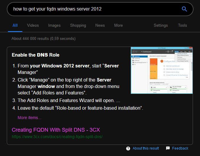

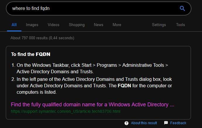

I googled where to find your fqdn, and this popped up:
I could not navigate to this on my local machine or the server. As this was simply not there in both cases.
So I googled how to get your fqdn windows server 2012 and this is what I found:
The link takes you here: https://www.3cx.com/docs/creating-fqdn-split-dns/

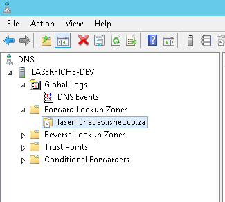

And now I am busy setting up my DNS roles as instructed on this website.
I got to a point where I was prompted to create a new host/domain and I called it laserfichedev.isnet.co.za
Do I enter this in the Endpoint Configuration Utility in the future?

replied on May 29, 2019

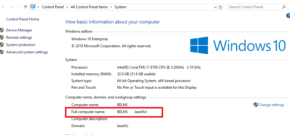

You definitely don't want to install the DNS role. You can get the fully qualified domain name of a machine from Windows Explorer (File Explorer in Win 10) by right-clicking on the "Computer" node (or "This PC' on newer versions of Windows) and selecting "properties" from the context menu.

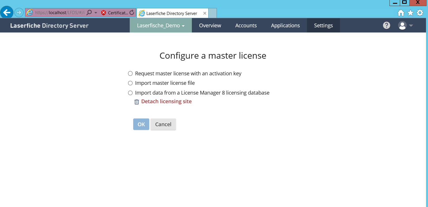

replied on December 15, 2017
Follow up and questions.
I ran the Laserfische Directory Server 10.2 setup on my VM1.  And, I went through all the steps until completed.  Then, the Laserfische Directory Server opened a url --> https://localhostLFDS and  prompted:
     Configure a master license
  • Request master license with an activation key
  • Import master license file
  • Import data from a License Manager 8 licensing database.

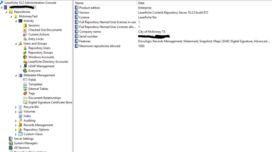

replied on December 15, 2017 Show version history
Hey Edwin,
The Admin Console screenshot you posted suggests that the City already has a Laserfiche Directory Server with an activated master license (the serial is not an activation key). As such, you can generate licenses for your test environment from the existing Laserfiche Directory Server, given appropriate permissions. A Rio master license can only be activated on one LFDS instance at a time.
If there is an administrator responsible for the City's existing LFDS, I would suggest getting in touch with them and requesting rights to generate the application licenses you need.
