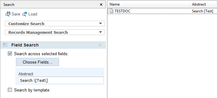

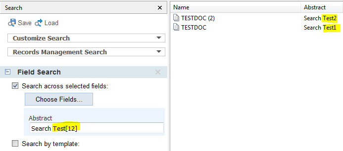

replied on December 13, 2017
The search is likely picking up the brackets as part of the syntax since they are used to identify character groups, if you use escape characters it should work.
For example,
If you search "T[io]m" you would receive hits for both Tom and Tim. I would try adding \ in front of each bracket to see if that works.
For example instead of searching "Bob Smith Company [BSC]" which is actually looking for "Bob Smith Company " followed by B, S, or C, I would try "Bob Smith Company \[BSC\]" which should tell LF Search to treat the brackets as literal characters.
