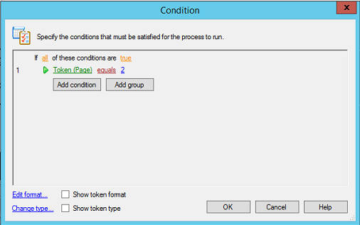

  1. Set your first page identification based on the "cover" page you already identified
  2. Under Page Processing
    • Add a "Conditional" process
    • Set the condition as "Page equals 2"
    • Right-click the "Conditional" process
      • Select "Insert Conditional Process"
      • Add your Zone OCR under the conditional to get the invoice total
What this does is tells Quick Fields how to identify your first page, then once it has a first page it will start processing the document and if one of the pages is page 2, it will execute the conditional processes.

replied on December 13, 2017
I have tried adding the class that contains the conditional process to a session that has Multiple classes and it will not work but in a session by itself it works???
