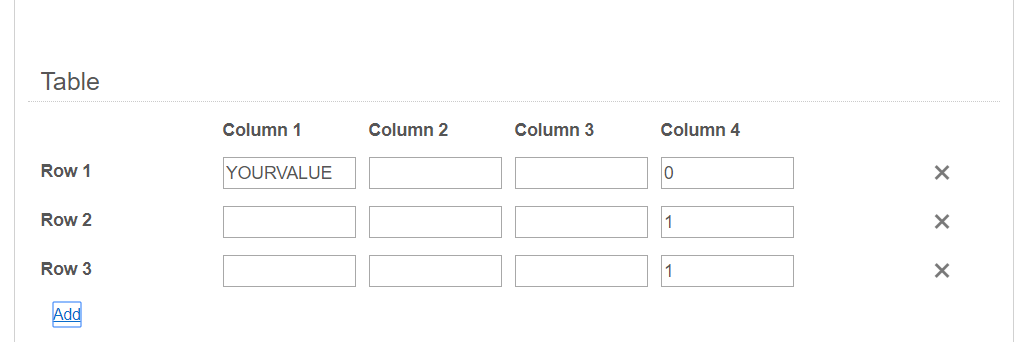

If you want to calculate a value for each row in your forms table, then you need to use the INDEX and ROW functions. Otherwise you get the behaviour that you're seeing now. Since you're also using the IF function, you will probably use it something like this:
=IF(INDEX(Table.Column_1,ROW())="YOURVALUE", 0, 1)

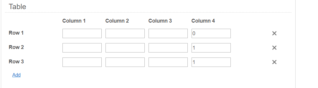

I've added the above formula to Column 4 in the example and when Column1 = "YOURVALUE" then it returns 0, otherwise is returns 1.
The next step is to ensure the formula only applies to the first row. We can either try tying it to static data in the table fields like the formula above that you know will not change or we can try to tell it to only refer to ROW()=1 which means row number 1. Here's the result below:
=IF(ROW()=1, 0, 1)
In this case, always return 0 when it's row number 1, otherwise return 1.
If you share some information about your table and variables, I can assist with writing out the formula for you.

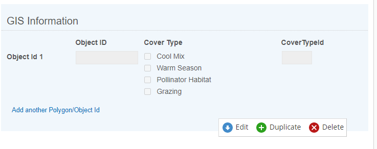

Hi!
I am having problems figuring out where to place the ROW() part in the formula I have:
=SUM(IF(GisObjectIdTable.CoverType.PP1=TRUE,1,0),IF(GisObjectIdTable.CoverType.PP2=TRUE,2,0),IF(GisObjectIdTable.CoverType.PP3=TRUE,4,0),IF(GisObjectIdTable.CoverType.PP4=TRUE,8,0))
I want this formula to run for each row depending on the choices the user makes. This is what my table looks like:

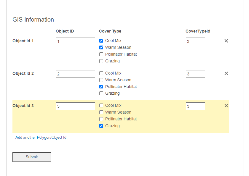

The CoverTypeId will be hidden, but the way I have it set up right now it's doing this:
So the formula is working for the first row and then using that same row input for all rows instead of calculating just for that row.
Any help is welcome. Thank you!!!
