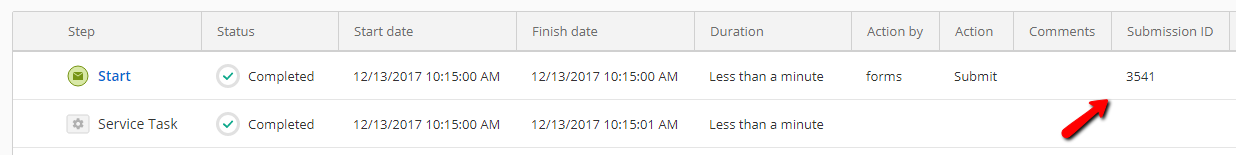

On the workflow that is started by Forms, did you have the "Started by Laserfiche Forms" option checked? This is not related with the token being empty issue but it could help check the issue.
If you have this option checked, can you check the tokens like "bp instance id" and "submission id" and see if the values match the ones on Forms instance history?
It look like this:
When you found the submission that match the one on Workflow, can you check click the step name and view submission on Forms and see if the values match?
If the submission id match but the values do not match, then it could be a bug. In this case, can you open a support case and give us your workflow/forms process so we can further check the issue? Thanks.

So what do I do if the "SubmissionBPInstanceID" matches the LF Form, but the FormsSubmissionID is 0? (Not the case for all of my suspended forms but a few)
