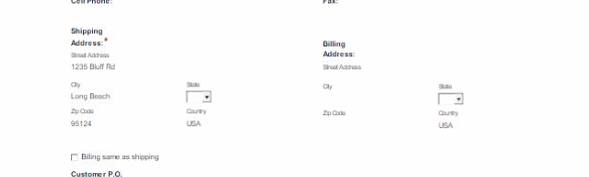

replied on December 7, 2017
I changed the javascript code as you requested but  when the form is submitted the State is still not saved.  I've attached a screenshot.
So there are more than one address field on the form? Then you will need to replace them separately since the field ids are different. Try the following:

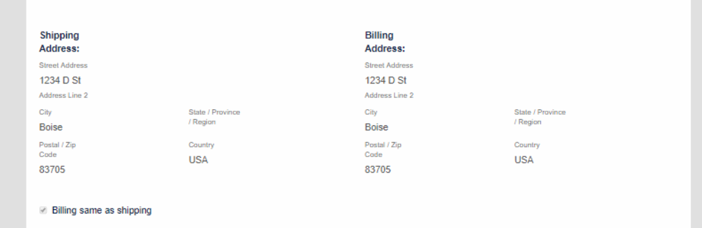

replied on March 30, 2018
This was working but now when I submit the form and it saves to the repository it does not show the state selected.  It just shows a drop down field, the field does save correctly to metadata though.  Do you think this is related to upgrading to 10.3?  I subsequently have now upgraded to 10.3.1 and it is still not working correctly.
replied on April 1, 2018
Hi Craig,
The original script did not handle the issue read-only form; actually it was a bug in Forms before 10.3 (reported in this post) that caused the script not being triggered on read-only form, which ended up making the read-only form looking fine.
After the bug was fixed in 10.3, you can update script like this to handle the issue on read-only form:
