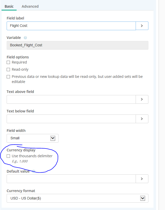

I had this same issue and I believe it was an issue with allowing a comma separator on the total.  If you go to field that's not updating and make sure "Use thousands delimiter" in unchecked.  It should work.   Fingers crossed for you!
You might need to go through all your fields and turn this off as well.
I would also recommend that if you have your total miles marked as read only.  I would make it read only via java and not by selecting the Field option.
