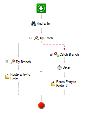

Here is an example of using the other method, a 'Try-Catch' block.  You set the delay in the catch activity to whatever you want time-wise, and then it will try again.  You can also loop these blocks inside each other if necessary for multiple tries.

I like the 'Try-Catch' block for this workflow and will give it a try. I thank you for the reference to both methods. If the 'Try-Catch' does not work for this one, I will be testing the retry time. Thank you for the help.
