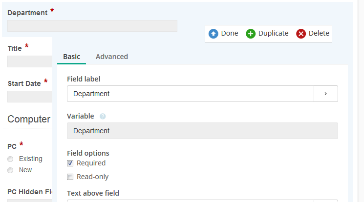

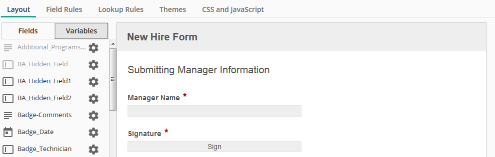

It should carry through read-only or not, unless the variable is different.  If you didn't copy the form over, what I usually do is to drag the initial variable to the new form from the variables menu:
That way you get the exact variable, and it will carry over.  If you have just named the field the same name on a different form, it has created a new variable and will have an extension number on the end like 'Manager_1' when the first manager field had just 'Manager'.  You can see the variable here:

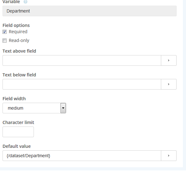

Notice the Department Variable has no extension after it.  If you do have a different variable name, you can still make the original carryover by putting the variable in the 'Default Value' field at the bottom of the edit screen for the field, like this:
