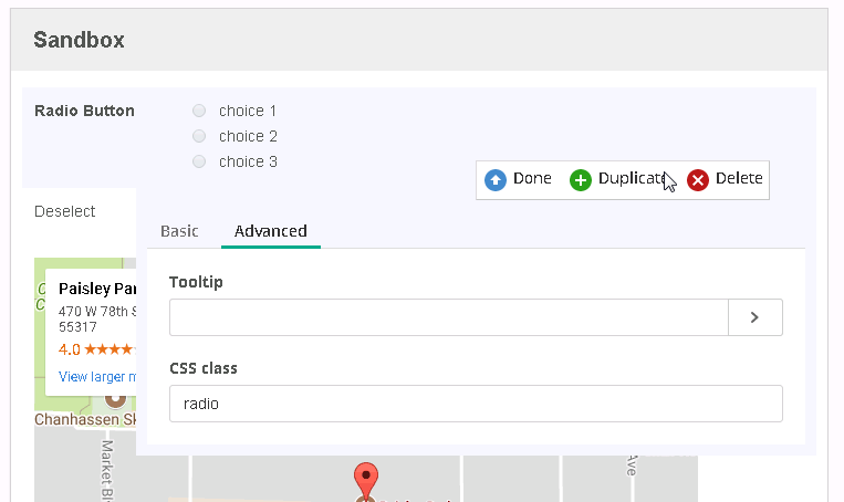

  1. Assign a class to your radio button group:

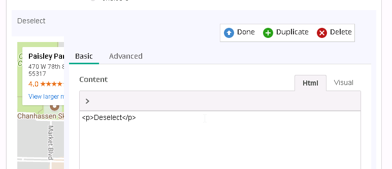

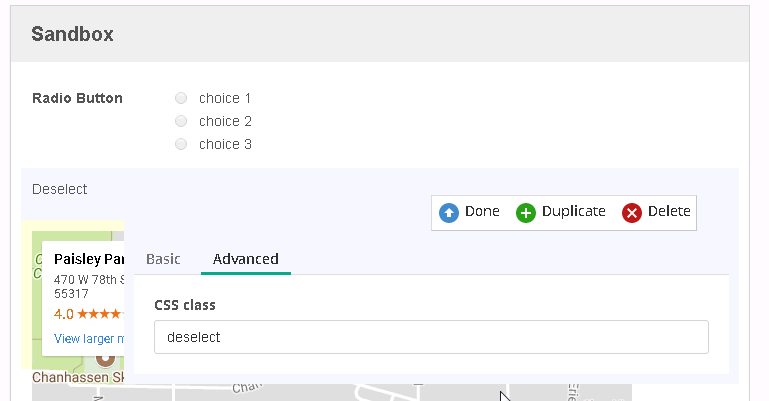

  2. Drop a "Custom HTML" "field" under your radio button group and assign it the class "deselect":

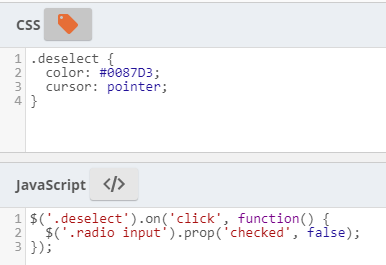

  3. Add the following CSS to the CSS pane under the CSS and JavaScript tab:
    .deselect {
      color: #0087D3;
      cursor: pointer;
  4. Add the following JS to the JS pane:
      $('.deselect').on('click', function() {
        $('.radio input').prop('checked', false);
And that should do it! Essentially, you're styling a paragraph (<p></p>) to look/behave like an anchor (<a></a>). The JavaScript unchecks the radio group when the "Deselect" "link" is clicked.

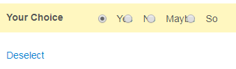

Thanks for the help. I have applied the codes, and also gave a css class to both my radio buttons, and html. But it doesn't seem to work. Clicking on deselect doesn't do anything to my radio buttons. Also my radio buttons looks different as well.

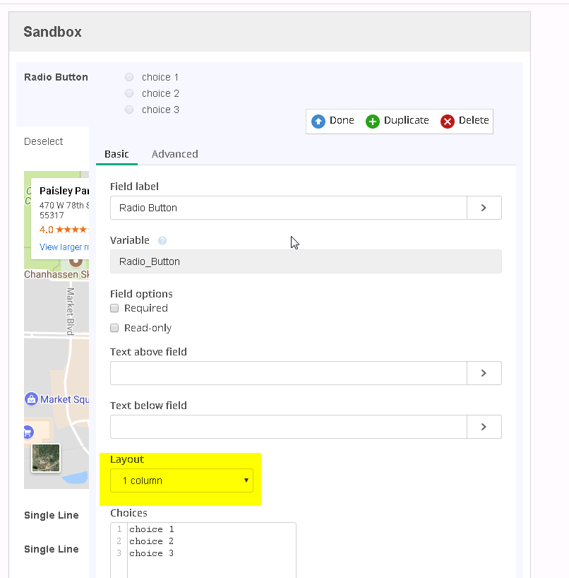

It's likely the case that your radio buttons look different than the ones from my example because your "Layout" setting is set to "Side by side", where mine is set to "1 column":
