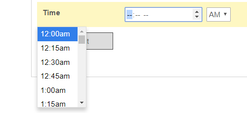

Hello everyone,
I have applied the timepicker js/css for a form I have helping with a customer and we got it to increment every 15 minutes, but now we are stuck with it not being a valid value. I am guessing it's the am/pm after the time... I am not sure how to format it or correct this for Forms.
We are using a Time field in the form's layout.
LFForms version 10.2.1.205
Thanks so much!

replied on November 6, 2017
I think your correct. With this type of field an AM/PM drop down has been added and the system expects only a time in the input box.
Can you remove am/pm from the text in your selection so that it doesn't violate?
If you want am/pm to be part of the same input field, try the time attribute set on a single line field using the javascript below. This time attribute works great on mobile devices too!

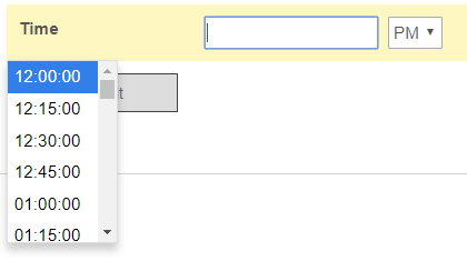

replied on November 7, 2017
I am trying to remove the am/pm from the text but can't seem to figure it out. I tried you code above and it did not work:
I got the time to format the way I wanted but now when I select the time, it does not stick to the field's value.
Here is my JavaScript code:
    $.getScript('http://localhost/forms/js/jquery.timepicker.js', function() {
      $('.meeting').timepicker({ 'step': 15, 'scrollDefault': 'now', 'timeFormat': 'h:i:s' });
      $('.meeting input').attr("type", "time");
