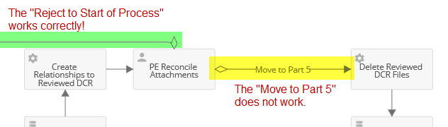

My Project Engineer (PE) has a step where they must review all attachments to the task and reconcile them. Once that's done, the PE has two choices: Reject to Start of Process (Reject) or Move to Part 5 (Approve). Reject works! Approve does nothing (it looks like it's being clicked, but I don't get any errors) ... not moving to the next task:

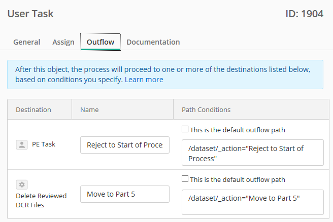

Here's some info from the PE Reconcile Attachments user task:

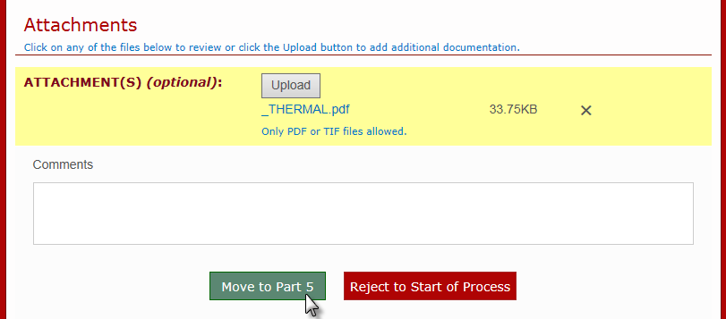

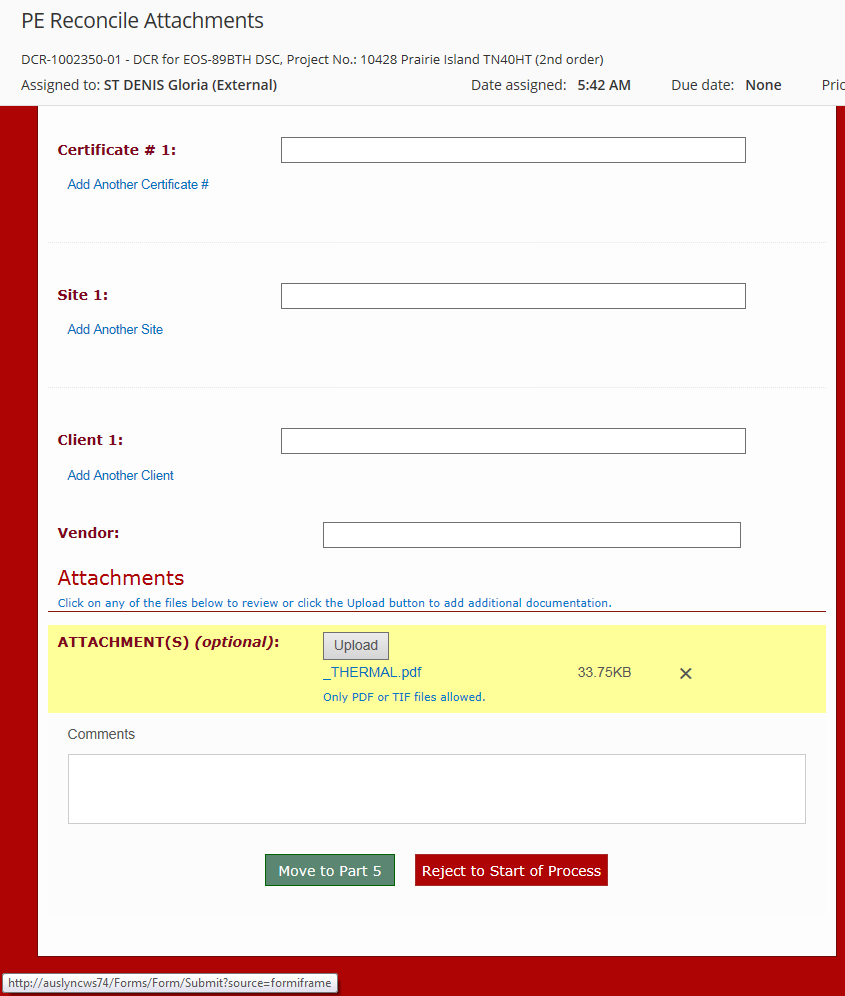

Here's what the bottom of the form looks like:
I can click the "Move to Part 5" button 25 times ... nothing. Here's the javascript I have in there:

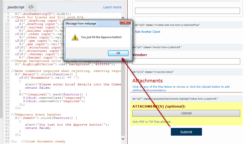

Okay, so next test, add another alert to the event handler before the condition; that way you can make sure it is actually firing. If you see the alert, then the problem may lie in the condition, if not, then there's something else going on.
replied on November 1, 2017
Additional info at the end of this.
The error handler worked when tested on CSS and JavaScript page:
Still doesn't work when I test on my form:

Is "Move to Part 5" using the "Submit" or "Approve" button?
At this point, I would put an alert on each one so you can see what's going on.
When you get back to this role the second time around, were both buttons not working, or just the "Move to Part 5" button?
replied on November 3, 2017
Move to Part 5 is using the Approve button.
The second time around, only the Move to Part 5 button was not working. The Reject to Start of Process works.
