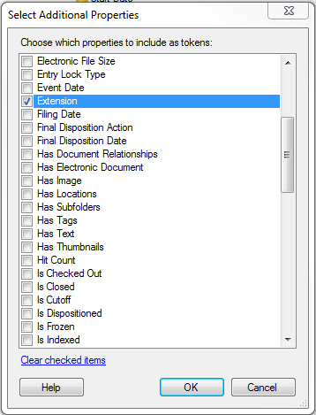

If you're using a Find Entry, Find Entries, or Search Repository activity, under Additional Properties there is an option for "Extension" that will provide the extension of the electronic file in Laserfiche.
Once that is added, you could use that to to get the complete file name with the .jpg at the end, just be sure to add the period between the name and extension.
%(ForEachEntry_CurrentEntry_Name).%(ForEachEntry_CurrentEntry_Extension)

No, that option just puts the extension in the Laserfiche entry name so it wouldn't be static like the extension property.

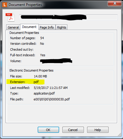

Find one of your test documents in the repository, right-click it, open Properties, and check under the Document tab to confirm it still has an extension.
Depending on your settings, some files like JPG, PNG, etc., may be automatically converted to Laserfiche Pages on import.
replied on October 31, 2017
I get results from the "search repository" but when testing query I get 0.  Also, I have no Electronic Document Properties when right clicking on the file.  It doesn't give me an extension or anything.  Just (Document has no electronic file) next to file size.  When I copy the file out of laserfiche onto my desktop it's a .pdf instead of a .jpg like it originally was before importing it.

Okay, then that means the files have been converted to Laserfiche pages, so they are no longer JPG files in the repository (Documents instead of Electronic Documents).
That being the case, you have two options

The extension is only available for electronic documents. Your JPG would become an image page when imported, with no electronic document component.
