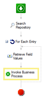

A simple workflow as you described would initiate the form:

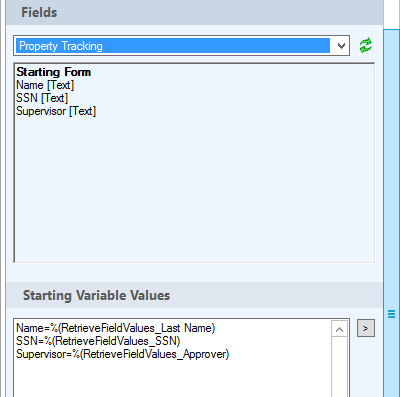

You are correct, the 'Invoke Business Process' will handle all the variables to fill in the form.  You do not need the 'Setup Business Process Variables' activity.   Just set all the starting variables in the 'Invoke Business Process'.

You could initiate the form hourly using a scheduled workflow and the 'Invoke Business Process' activity.

That would work but I have never initiated Forms directly from workflow. Basically, I want to search the repository and create a form for each qualifying document passing the metadata and attaching the image to the form. I have set up the Invoke Business Process in my workflow. Do I need to do 'Setup Business Process Variables'? It appears that Invoke Business Process handles this.

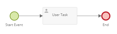

Also, what activity captures this info in the Form's Process Diagram? The Workflow Service Task initiates a call to workflow but I do not know what activity captures the info that is initiated by workflow itself. Thanks so much for your assistance!

Just to clarify, based on your last paragraph ...   If your goal is to initiate a form every hour this will be accomplished entirely from a scheduled workflow, not your forms business process.   Unless your forms business process requires an additional workflow that performs other work, you do not need a Workflow Service Task in your Forms Business Process.
