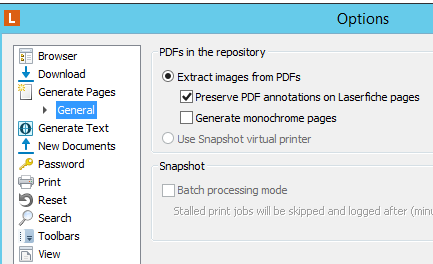

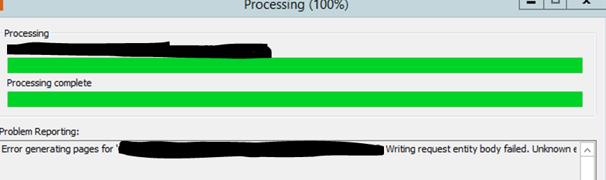

What seems to be happening is, when opening a file and making a minor change on it, be it change a word, or even remove a word and save it back into Laserfiche, it tries to generate pages and at times failing and showing the below:

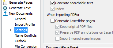

Is there a way this can be stopped? I have checked the options, and the below is what is setup:
The client is questioning the time it is taking to save a file back into Laserfiche which at times is very long even after a small change,
Thank you
Ziad
replied on October 24, 2017
This is not currently configurable but we will look into adding an option to allow the user to bypass the page generation (bug# 51125).

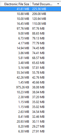

replied on January 29, 2018
Hi Robert,
As per attachment, is there a way these generated pages can be removed from these documents? The sizes being created in these files are huge?
Thank you
Ziad

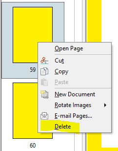

replied on January 30, 2018
The pages can be deleted from the thumbnail pane in the doc viewer.
Thanks Robert,
If we require a Workflow to get these removed? is this possible? Or do they have to be manually done as per below?
And just to confirm, this will only delete the Laserfiche pages? and not the file itself?
Thank you
Ziad
Workflow is probably your best bet. Deleting the pages from the doc viewer will not delete the edoc portion (just the image/text/thumbnail portion).
